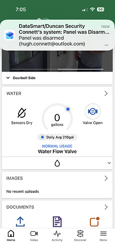

I have the ADC Smart valve installed and it seems to be measuring water flow properly. After three weeks of installation and regular water use, it has alarmed every morning at 7:59AM and closes. It is reporting “unusual water use” as the message. Immediately prior to this happening the valve is reporting “Normal water use” in the app.
I understand that the valve “strokes” every day to keep it from getting stuck from being open all the time. It seems like when it goes into that process it reads the water use for the day and thinks its all recent and goes into alarm.
