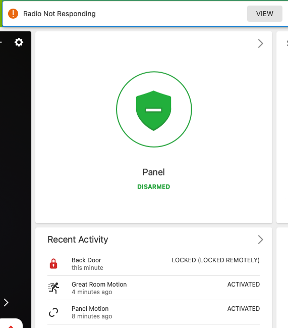

For days now, I’ve been unable to communicate with my panel using the app, it displays a radio communication error. Can’t arm/disarm, none of my automation rules work etc. Everything I do on the panel is sluggish, presumably due to a communications loss from a non-responsive hosted application.
I’ve done the power down panel, restart router, power panel back up with no change. It’s connected to my wifi just fine, every other device in the house works including my Liftmaster gateway showing green lights etc.

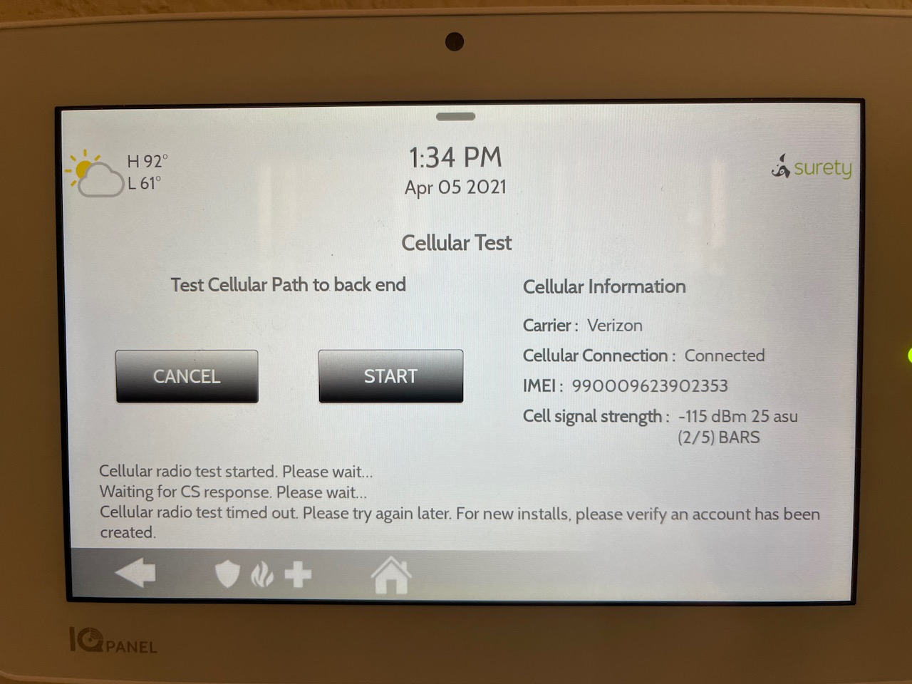

I can confirm that the back end is not down. This is probably going to be a panel level software issue. The panel is not responding to any ping I am sending right now cell or broadband despite showing a wifi connection locally. System details in ADC are correct.

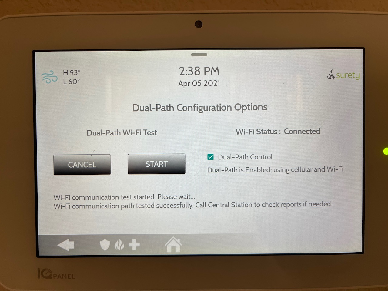

Was able to download and install 2.5.5 firmware successfully.
System panel downloaded all my zones and sensors from “the cloud servers” and I’m assuming that means ADC. It also ostensibly successfully completed a WiFi dual path test after the initial setup in 2.5.5.
System still not communicating with ADC and showing offline in my app.
ADC’s trouble condition may take a short bit to restore. The actual communication trouble condition is restored when a cell signal is received and ADC can communicate to the panel.
Panel pings just went through for me and I see your manual phone tests.
