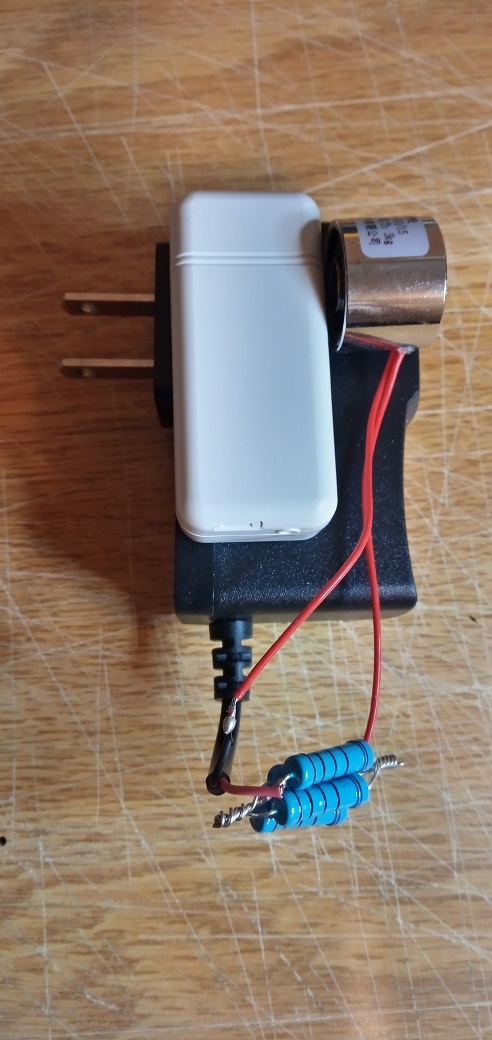

I thought I’d share – this worked great! I made an “outlet monitor” that behaves as a window/door sensor, and can be automated thru alarm.com to turn on/off my normal switched outlets when the hardwired/monitored outlet turns on/off!
The outlet monitor for the hardwired outlet is made of:
- 12VDC AC adapter
- 12VDC electromagnet
- 25 ohm resistor (4x 100 ohm resistors in parallel)
- QOLSYS IQ DW MINI S-LINE Encrypted Door/Window Sensor
And the remote switched outlets are:
I chose the resistor count to allow the sensor to trigger while not getting the electromagnet too hot (since it will be on continuously, and the electromagnet is rated for 50% duty cycle).
So now… When we flip the existing hardwired wall switch, not only does the hardwired outlet turn on/off, but two other Honeywell outlets on the other side of the room do as well!
PS this would be even nicer if I could plug thru the AC adapter!
