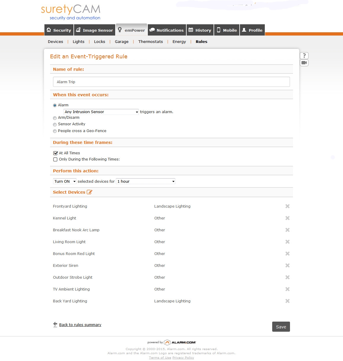

This rule was working before. When my alarm get triggered, I want it to turn on lights, and an exterior siren plugged into a z-wave switch. I have attached the rule.
When the alarm is triggered, it does not trigger ANY of those devices listed. Please help
From what I understand, the mere presence of the devices indicate that they are selected.

It could be your browser. Delete the rule on alarm.com, and recreate it in another supported browser. On mine (chrome and IE), the devices are present whether they are selected or not.
I did it in a different Browser. IE. Same thing. I dont have those checkmarks. It should be noted that in the summary page of all my rules it shows all the devices under that rule
Then that is your problem. You should have those check marks (especially if in IE browser) . for whatever reason, your devices are not selectable. Resolve that.
There should be check marks, not just “Xs” next to the devices. We’re working with ADC on it, but it would be helpful to know when the rule last worked properly.
I’ve just learned if you have more than 10 lighting devices to choose from, the display changes to that which you are seeing (vs the check marks shown above). This may be a new change, as I’ve never noticed before.
