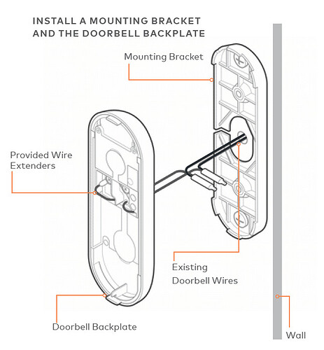

The USB port is behind the camera and accessible once you remove it from the mount.
The back plate stays on the mount, you just need the front portion of the camera.
You can view the latches on the backplate in the diagram below. Use a small flat head screwdriver in the slot on the bottom to apply pressure and release the latch.

Just to be clear. I found the slot on the bottom. I am assuming I press up with a. Flat head and as I do that I rotate the camera out as if there were a hinge at the top of the camera?
How much pressure to apply to the slot with a flat head screwdriver. I assume I press and pull it out at the same time.
Just don’t want to break anything
You can pull outward on the bottom of the doorbell while applying a little upward pressure with the flat head screw driver, It should come off without too much struggle.

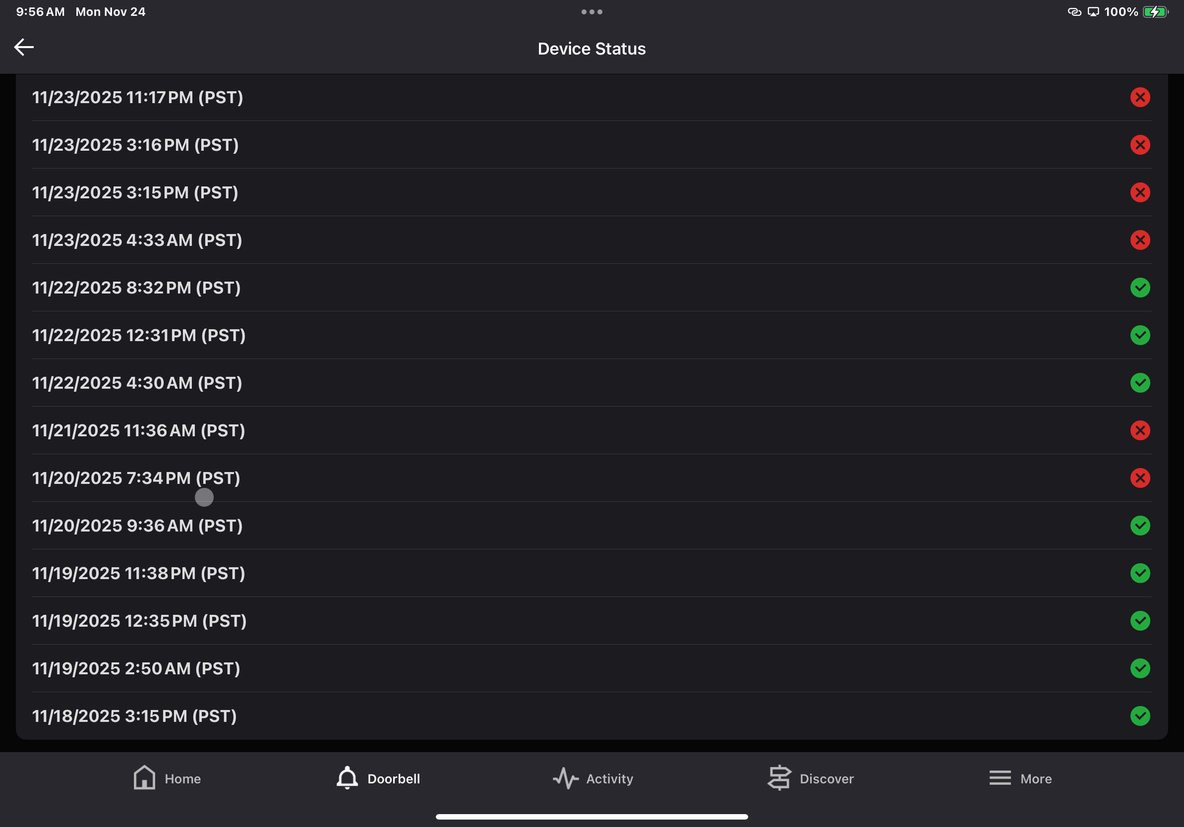

The wifi signal strength seems plenty strong enough currently, looking at your camera diagnostics. If you run into any issues I would recommend trying 2.4.
