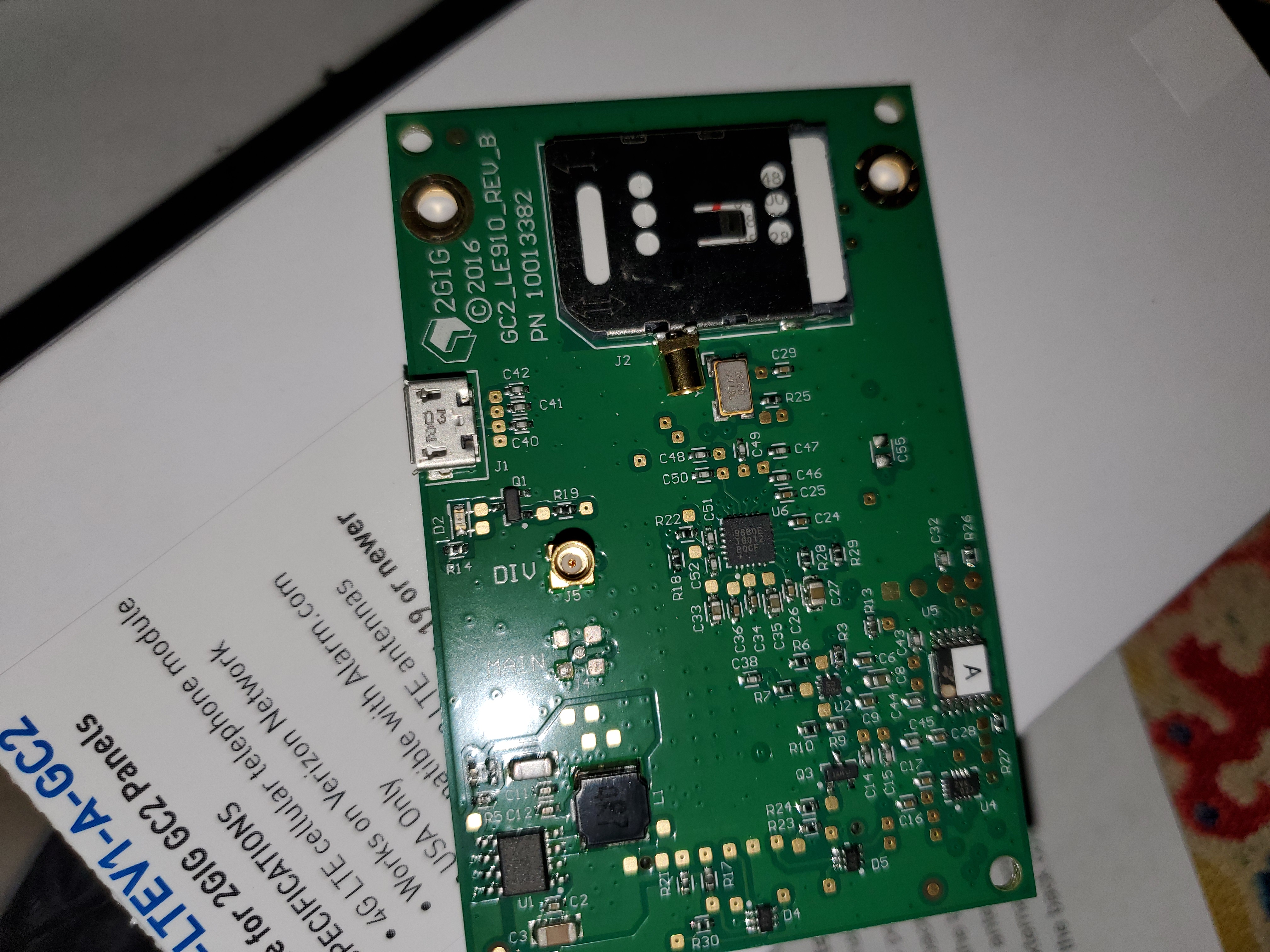

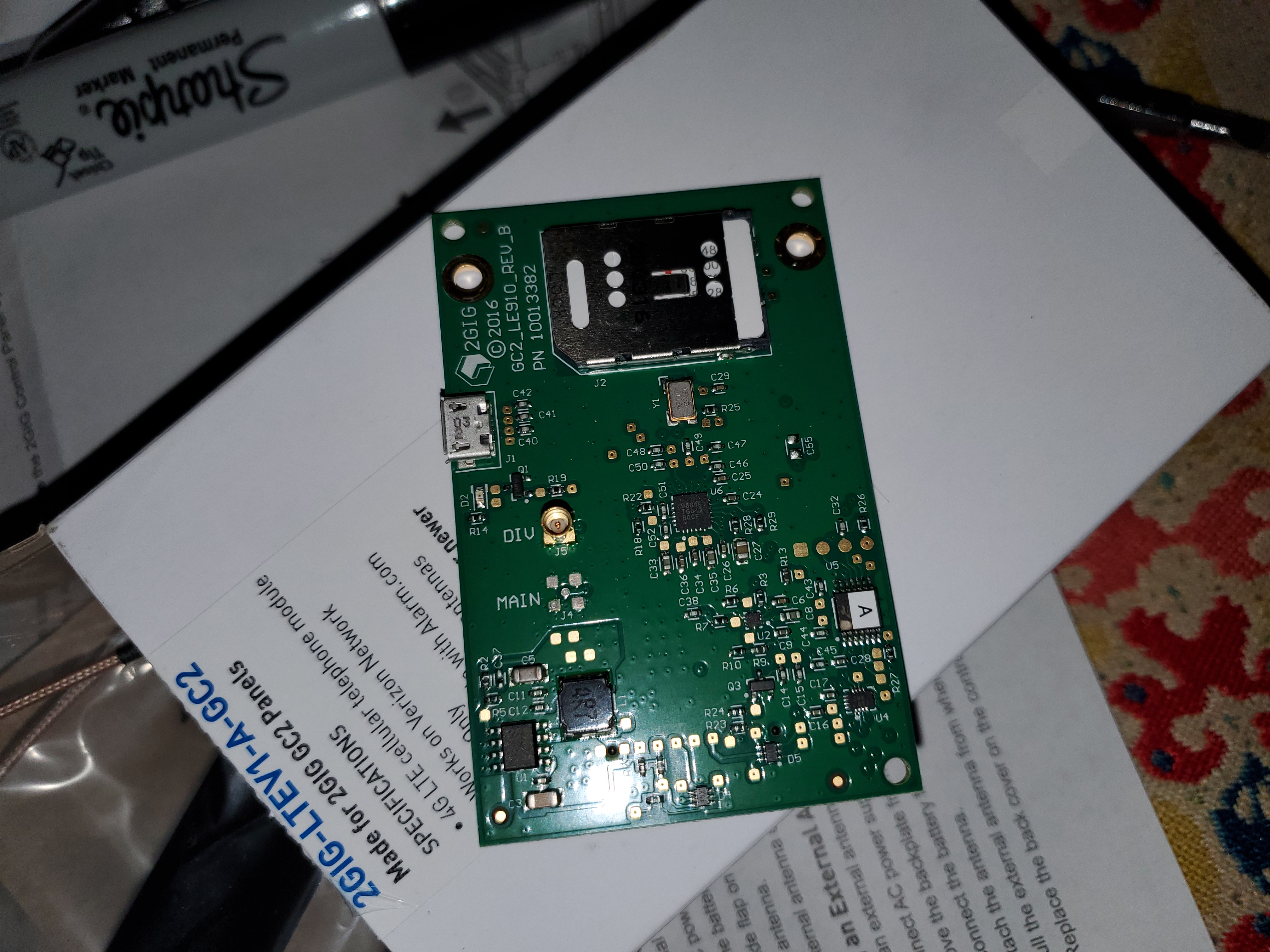

Just opened up my package and the part I received is defective. One of the 2 ports where the antennas get connected is broken off the board. It was just in the bag. What is the process for replacing it?! My Order # is 501157 20200929_102811|666x500
I’m sorry to hear that. Customer service has been notified and they are currently getting the warranty return processed squared away. They will follow up via email with additional information.
Ok! Looking forward to hearing from them.
