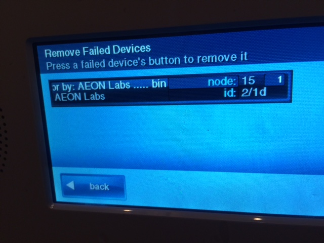

Tried to install this sensor (several times) http://aeotec.com/homeautomation and keep getting an error (see attached pix). Is this particular Aeotec z-wave sensor not compatible w/2gig? Also, I tried the SmartThings Multi-sensor as well just for fun but also had an error. LMK your thoughts about these or if I’m exceeding some kind of sensor/z-wave device limit I’m unaware of. -thx
Z-wave sensors will not be compatible with the 2GIG panel (or any other) at this time. In general sensor type Z-wave device command classes are not supported.
