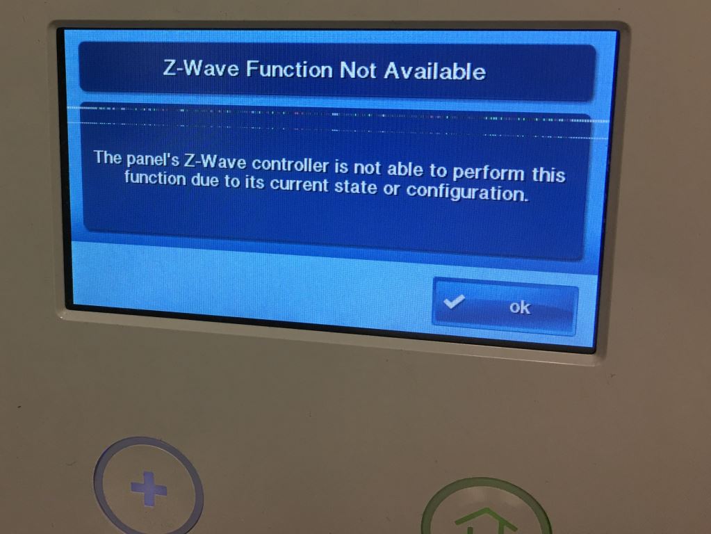

Unable to add Z-Wave Devices. All Z-Wave options are on in the installer toolbox:
Q79 = 3
Q80 = 1
Q81 = 1
Q82 = 1
When I choose to add a new Z-Wave device I receive the response in the attached picture - “The panel’s Z-Wave controller is not able to perform this function due to its current state or configuration.” I have reset the Z-Wave Controller more than once.
