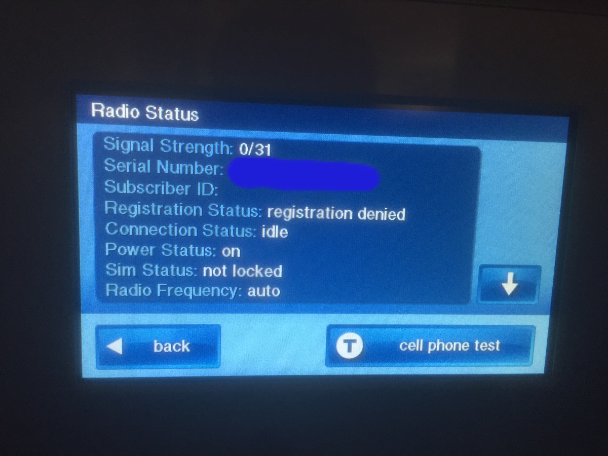

I had to take down my 2gig control panel and reset the power after trying to reset the system, my radio status shows a strength of 0/31. I reconnected the cell phone module and made sure all connections were tight. I did a hard reset of the system and I am still not getting signal strength to communicate with central monitoring.

I followed the instructions in the video and my signal strength is still 0/31.
