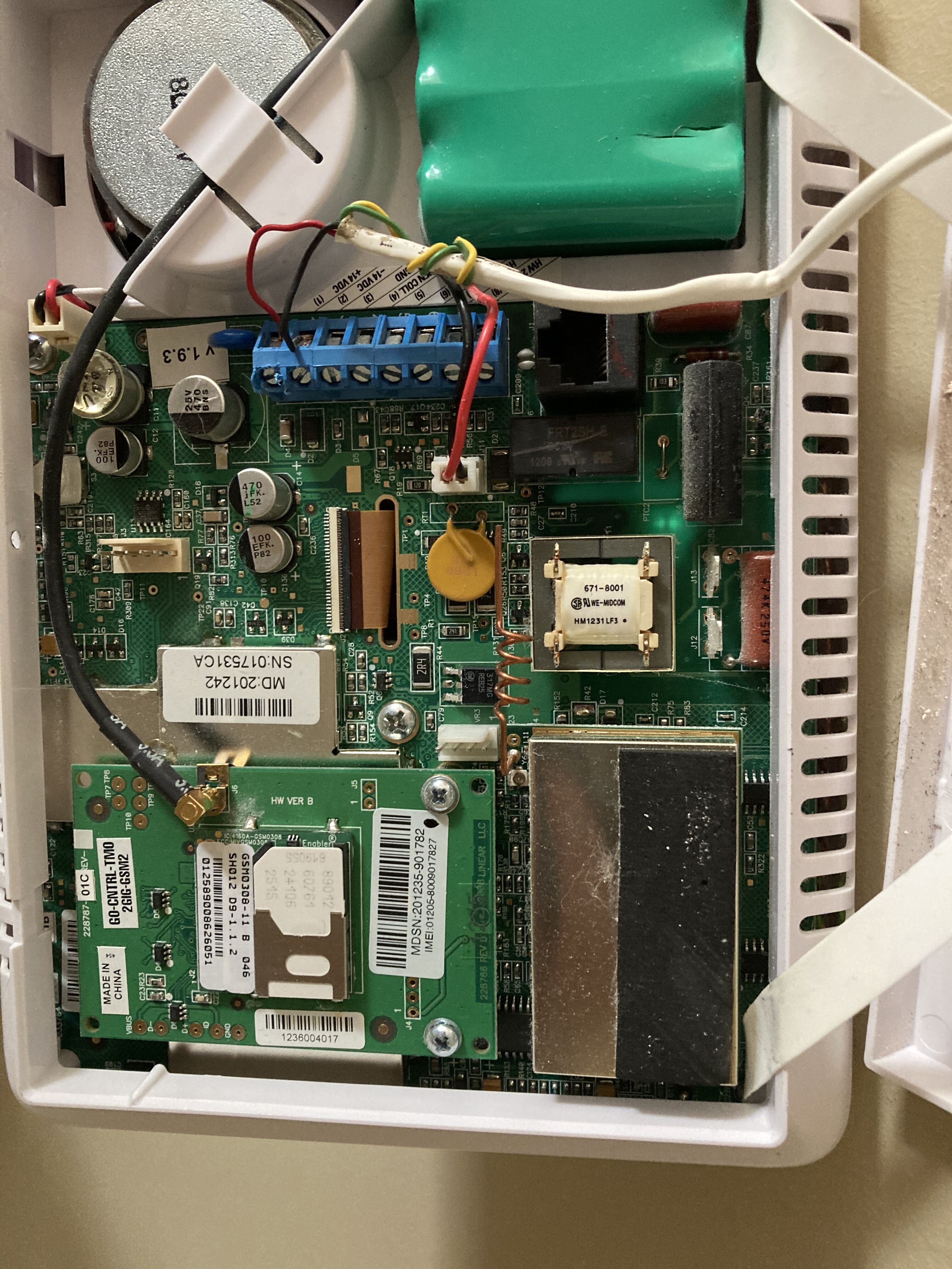

I checked the speaker just now and do not see anything loose or out of the ordinary, though I am just a novice. I am attaching a photo of what I’m seeing. Do you see anything out of the norm?

Based on the picture, the wiring looks fine, as long as nothing is loose.
This is one of the older 2GIG Go!Control units and it may just be on its way out. Do you notice the crackling noise coincide with any panel alerts on screen?
