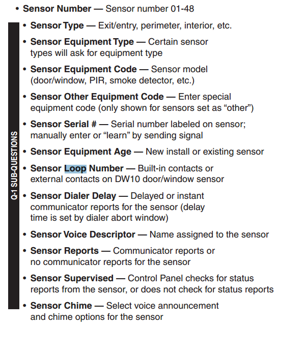

Is there any place that explains the configuration items so I can learn more about it?
Individual descriptions can be found in posts and in your panel manual. See attachment.
Loop specifically refers to the function of the sensor your panel is monitoring. Certain sensors are multi-function. DW10, for example, has a hardwired loop input and a built in reed switch.
You do not need to choose which to use, the same sensor serial number can be programmed in for both because they are differentiated by “Loop” with the hardwired loop 1 and reed switch loop 2.
