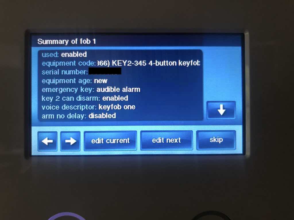

For reference here is my 2GIG configuration. emergency key (panic) is holding the top two 2 buttons on the 2GIG-KEY2. key 4 output, the auxiliary button on the keyfob is disabled. As you pointed out, I’ve paired the auxiliary button with my GDR1.
