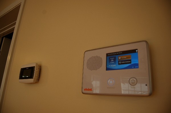

This control panel uses a 12V transformer for its power source with a 4-ft wire. If the panel is mounted on the wall, you will see the wire dropping down to the electrical outlet. This is not particularly pleasing to the eye. Any suggestions about how to hide the wire and/or transformer? How do others deal with a wall-mounted panel’s power source? None of the sales literature show it with the transformer wire. Attached is a picture of a Vivint’s Go!Control panel but there is no transformer wire. How did they do that?
Use a coat hanger (or fish tape), run wire behind panel in wall for main panel and TS1… For longer behind wall runs, use a keyhole saw to cut a narrow trench to push wire into, then patch with DAP, sand, and repaint.
Thanks. It appears the wire is hidden behind the transformer at the bottom of the outlet cover. I’m guessing that a small hole was cut in the drywall below the outlet cover and the wire was pulled up, behind the wall to the panel.
