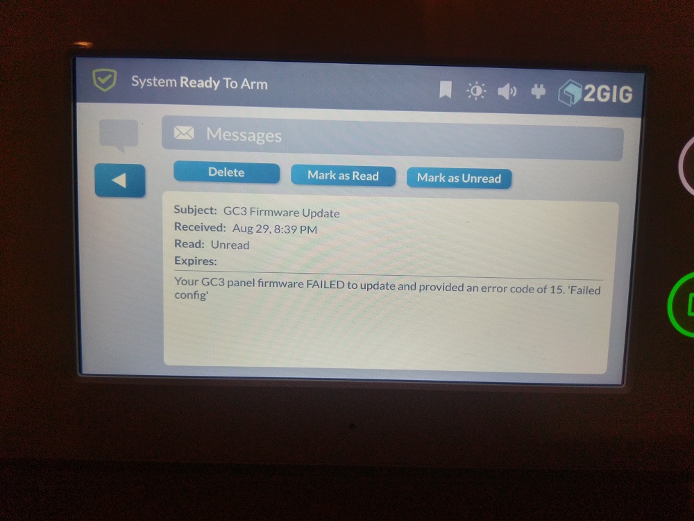

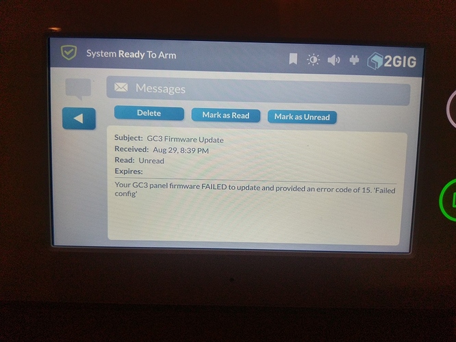

After running the firmware update everything seemed to go fine and it restarted a few times. After the final reboot, a message appeared saying there was an error 15 and it was unable to update the firmware. The system info after the reboot says the firmware is 3.1.0.

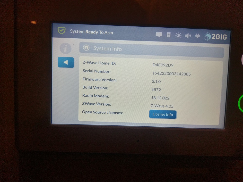

What you will want to check is the build version number. Navigate to system info and usage -> system info to confirm the build version number. Are you seeing 5572 (the newest version of 3.1) or something different?

The system info after the Error 15 said 3.1.0 5572, so has the panel updated or did the Update fail as the message said? Should I factory reset the panel? Any idea what Error 15 might have been caused by?
If you show version 3.1.0 build 5572, that would indicate that firmware did indeed update successfully. The error is likely related to the fact that device programming was lost, but we have not run into that on a production firmware version, so something unique occurred in that case. We will see if 2GIG has any input on that error.
