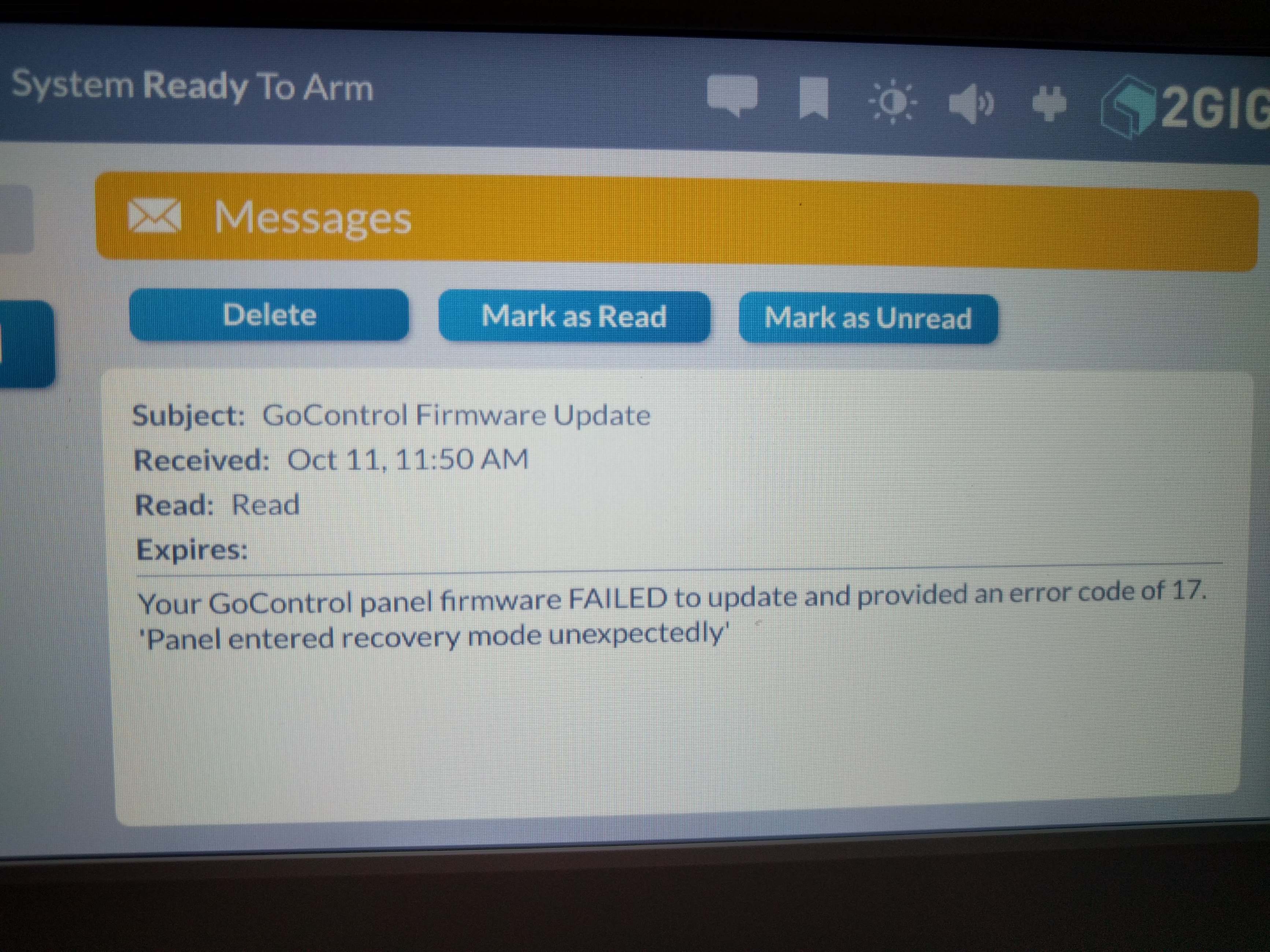

OK, I did this and the panel seemed to install everything, went through a reset. Then when it came back on, I got a message saying the install had failed, Error Code 17 the system entered recovery mode unexpectedly.
I tried it again and got the same message. Does not seem to be working.
Please attempt to upgrade the firmware again via USB and should it fail, please take a picture of the error message that you receive and sent that to us so that we may investigate further.

Please see the attached picture of the error message.

The firmware update issue is unrelated to the other, and unfortunate as 3.1 is required to help resolve the other. I understand the concern, and we are happy to assist. 3.1 downloaded from above, is it the only file on the USB drive? Has this update failed three times with the exact same error each time?
We have heard a couple reports that are similar, resulting in error code 17. These appear related to the Build Version of the GC3 firmware being updated. Under system info and usage - system info, what is the Build Version number for your current firmware?
Yes, tried 3 separate times. On the last try, I reformatted the thumb drive and re-downloaded the firmware file, with no difference. Yes, only file on the drive - it was formatted before use. The build code is 5036.

We’ve reached out to 2GIG for any additional details. From the initial response it sounds like it may be a warranty replacement issue if it fails to update and remains on 3.0.2.
The issue has been escalated to a 2GIG engineer and we expect to hear from them tomorrow regarding any possible resolution. We will update this thread with any details. If 2GIG confirms there to be no fix, or we do not receive word, I would then recommend pursuing a warranty replacement per the linked policy.
As an update, we haven’t heard back yet from engineering, and I am inclined to say this is a warranty issue. I’ve not found a panel that has refused to update from a production 3.0.2 version to 3.1.
This would be handled under standard warranty. Our warranty policy and return options are found here. Let us know at customerservice@suretyDIY.com if you have any questions.
