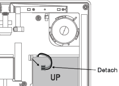

  4. Carefully detach the power cable from the battery to be replaced.

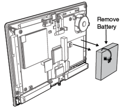

  5. Carefully detach the battery from the panel.
    Note : You may need to apply a reasonable amount of force to separate the battery from the adhesive that holds it in place.

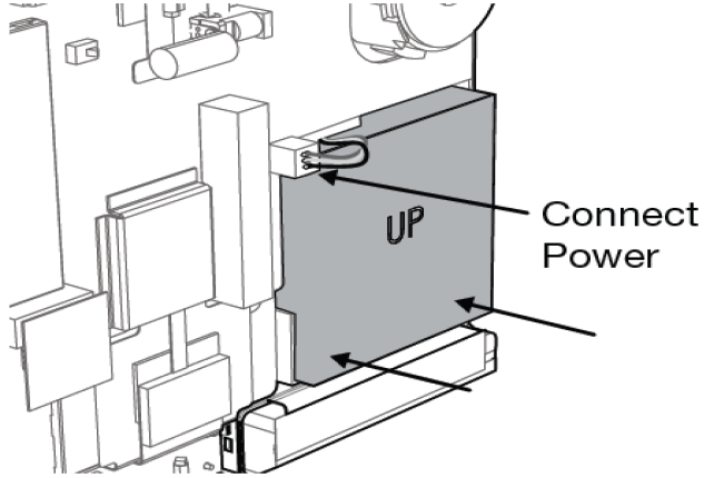

  6. Peel off the adhesive strip from the back of the new battery.
  7. Insert the new battery, and attach the power cable.
  8. Replace the back cover.
