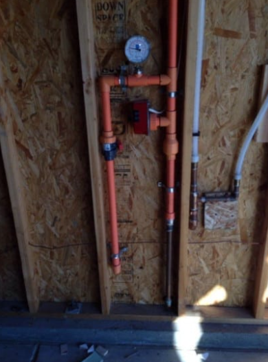

By fire valve, I imagine they are talking about the sprinkler system?
The sprinkler system has a riser usually in the garage. It looks something like this. It could be covered behind drywall but has a hatch to get access to it.
The red box should have several wires come out. One of those wires should be a thin wire leading to the wireless sensor monitoring it.
