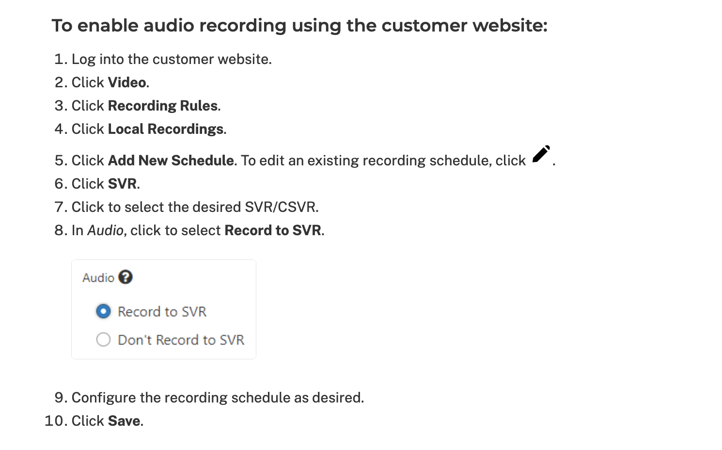

Is there any setup I have to do on my end as I am not getting audio when reviewing footage from the SVR on the website or app. Is it only when reviewing from the SVR directly?

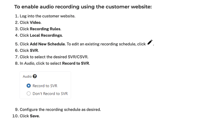

It needs to be selected within the Local recording rules. There is an Audio recording section when editing the rule which lets you specify if that stream will have audio recorded.
Alarm.com > Video > Recording Rules > Local Recordings.
If you do not see the option you may need to create a new rule.

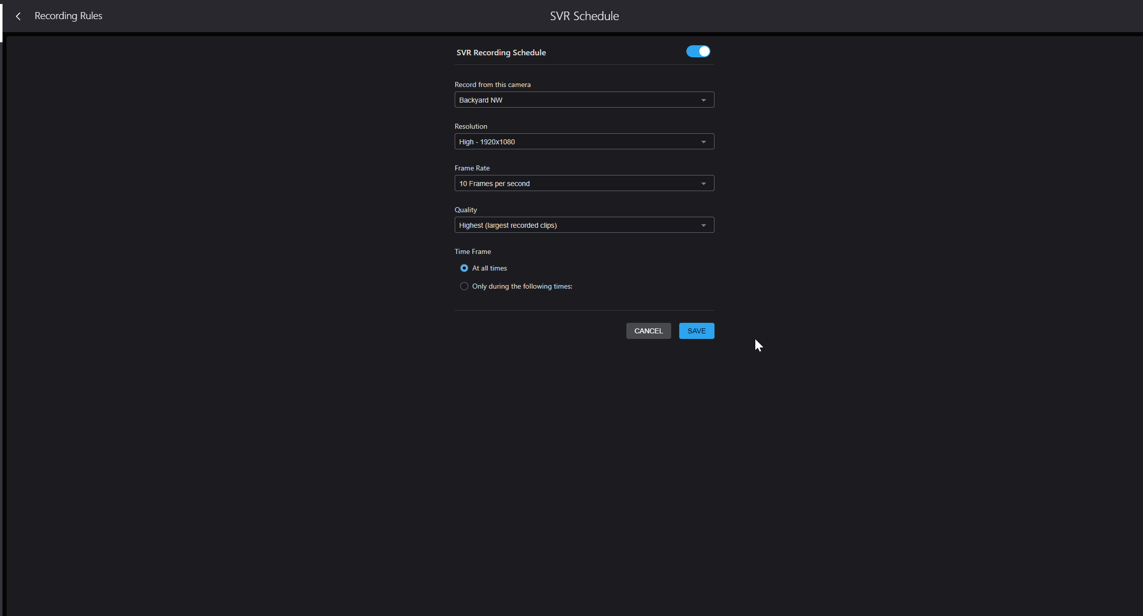

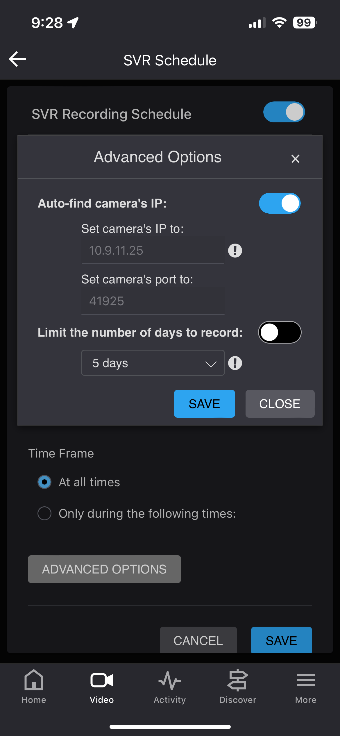

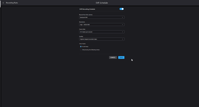

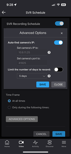

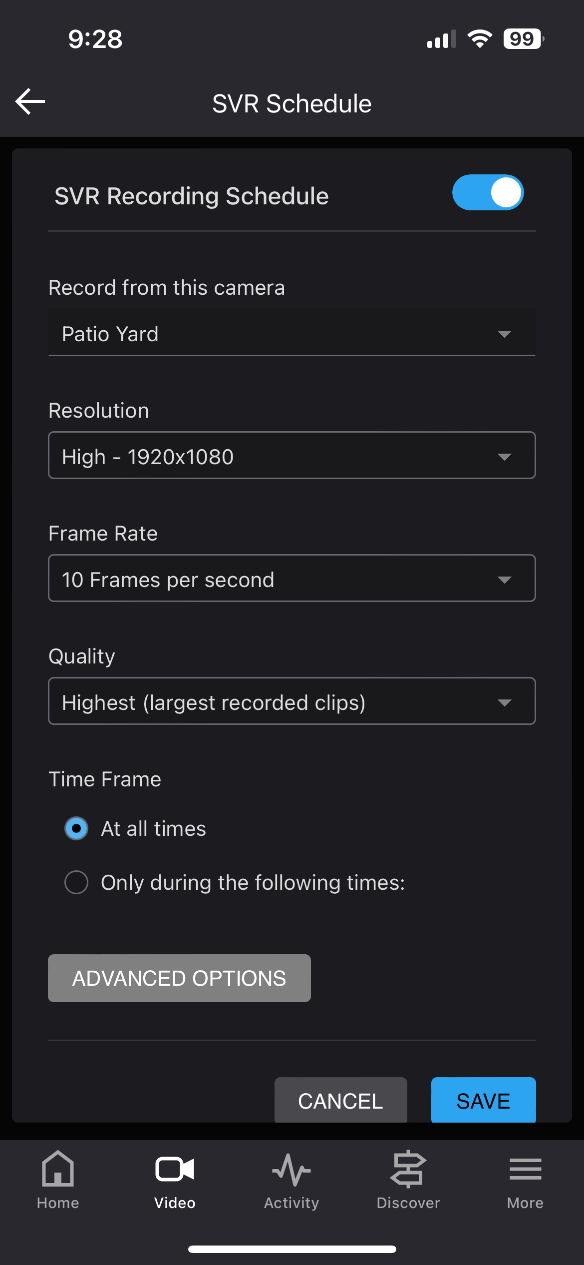

Hey Jason!
I’m still not seeing those options on the app or site even after deleting and recreating the rules. Please see that attached pictures. Any advice?
Apologies, I should have specified. The instructions are for it to be configured on the Alarm.com website at this time, not the app.
Ah, I see the issue. The feature is limited to the newer CSVRs at this time. The CSVR126 is not compatible based on documentation. It looks like you are using a CSVR126, correct? Compatible models called out in docs are below:
