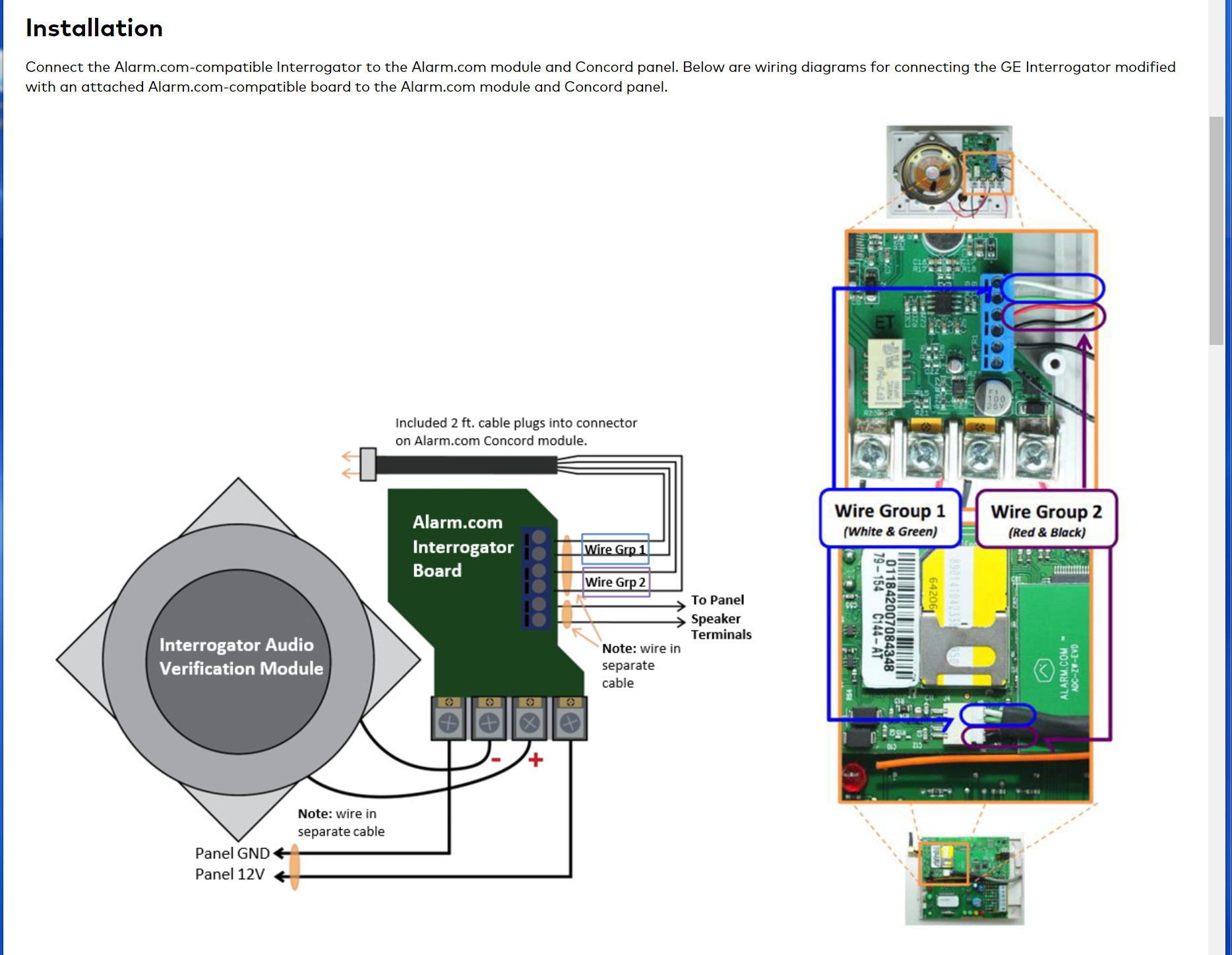

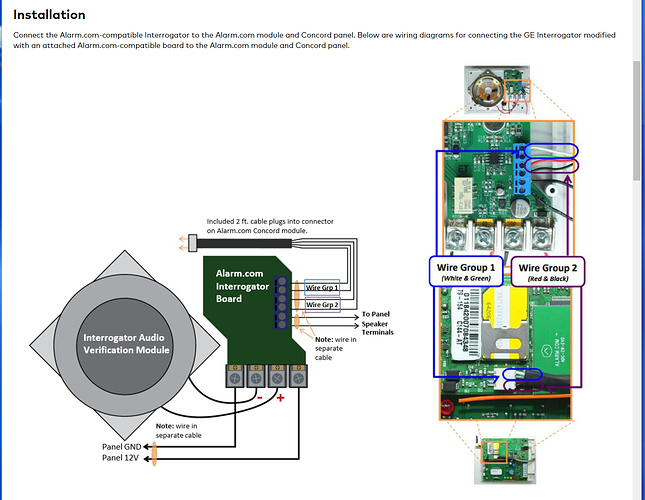

Note that the installation is a bit different when it comes to Alarm.com Cellular 2-way Voice. See the attached file for wiring diagram.
Thanks again Jason!
I found your Using your Concord 4 page, but I hadn’t seen that AVM wiring diagram yet - I’m very glad that I won’t be doing this without it!
