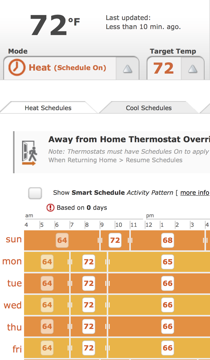

Hi - yes, I did both - did it again just now for giggles. All looks clear. In fact I know that communications are working on both ADC/cell and z-wave sides because I can interact with the web site and control zwave devices manually. Take a look at this screen shot. You can clearly see that the schedule is on and the setpoint at 72 but according to the schedule should be 66. Hitting save after changing a value still doesn’t change things.

I have spoken at length with ADC reps. They are looking into this and sending some commands to re-establish the schedule. Check back and see if your thermostats begin following the schedule that was previously set. If not, the next step would be to remove the schedule, save, then re-add to force a new schedule to be sent to the panel.
Communication seems clear though, so it looks to be an issue with the schedule being saved at the panel side. You have AC working on both thermostats.
