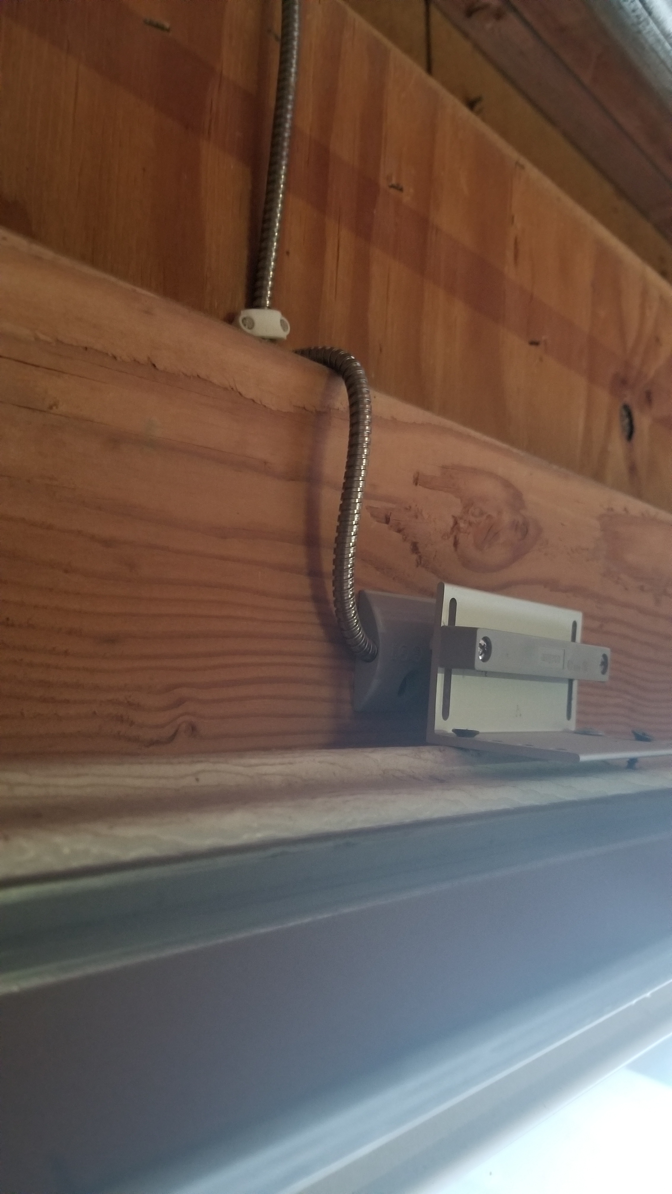

Sorry, here is a pic
I believe it is the one on your site…Miniature Overhead Door Switch (4532L)
Thank you for the pic!
The device labelled garage door appears to be set up correctly in the back end for this set up, aside from not having and Equipment Code listed which should be existing door/window
The magnet looks to be in the right place on the door and the gap between the 4532L reed switch and the magnet looks to be well under 2". Is the wiring firmly attached?
Weird it was working before, I will check the connections again. As to the equipment code listed it shows door window contact on my panel…specifically the dw10
So if I remove the wires connected to the sensor, in the walk test mode, it triggers the garage door. When I connect the wires again, it triggers the garage door, however when I try it opening and closing the garage, it does not work.
Run was either to long or broken inbetween. I connected it directly to the 4532L and it worked…thanks for your help…
