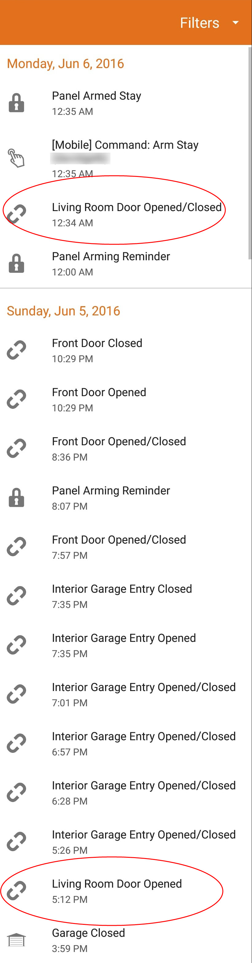

There is one sensor (DW10) I have on a living room door that after opening the door, will not report that it has been closed on ADC. Last night, I went to arm my system from my phone and noticed it was reporting that a sensor was open. I went to the panel and it showed all was closed and ready to arm. ADC was reporting that the sensor was still open. I opened and closed the door and then it reported correctly on ADC. (Screenshot attached)
What would be causing this one sensor to report correctly in the house but not relay to ADC? Could this be a faulty sensor? I have several other sensors within 3 feet to each side of this one and they never have this issue, so I am fairly sure it is not environmental. But the fact that it reports correctly to the panel makes me wonder if it is a sensor issue or if it is an ADC problem.

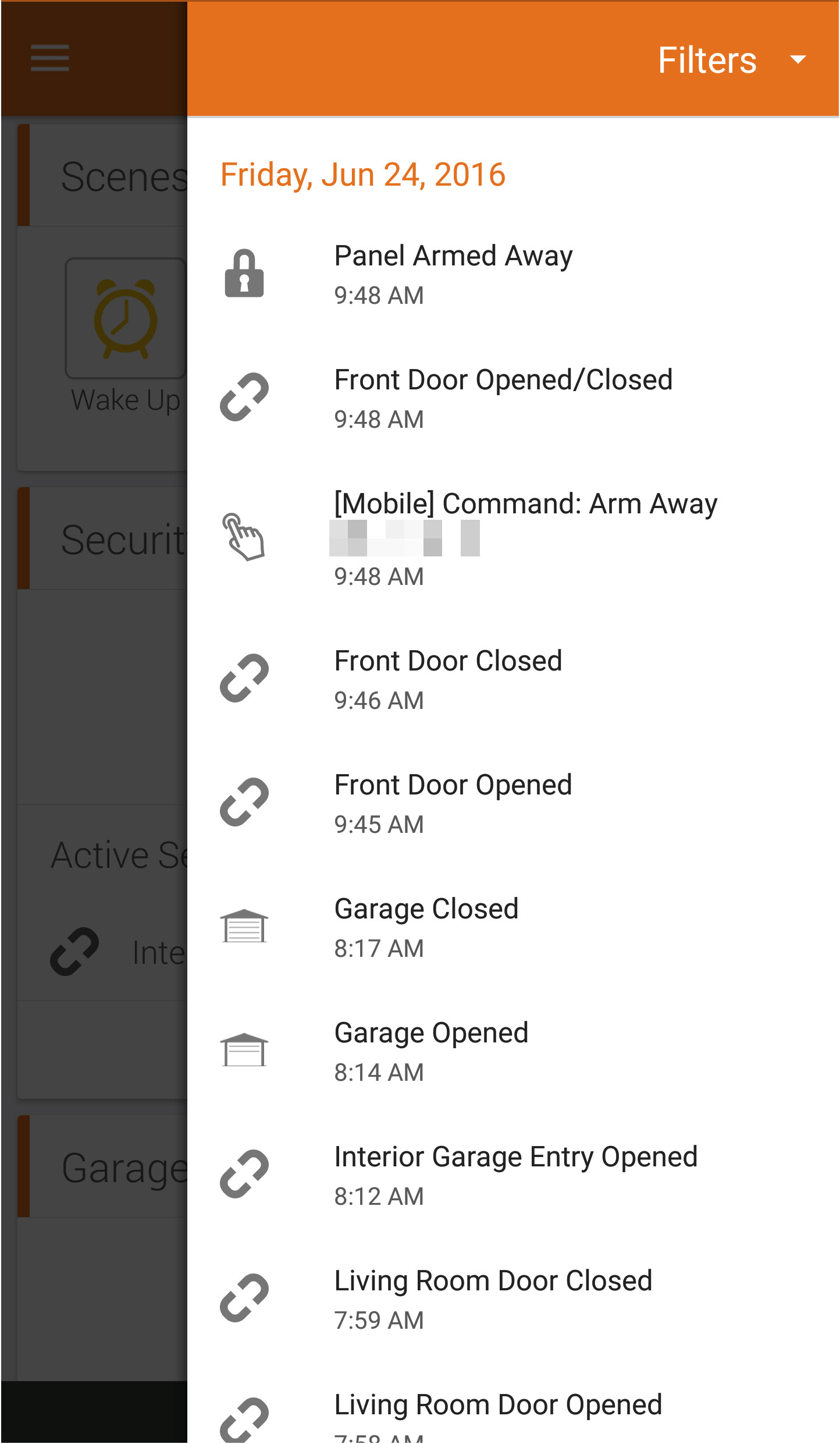

Today, I left the house and when I went to arm the GC3 via my phone and noticed that it said the door I exited from had been opened but not closed. I opened and closed it twice (it only reported once to ADC) although the panel was showing that it was closed. Again, it reported out of order (as you can see from the attached screenshot…it says I opened the front door, then armed the panel…but in fact, I opened and closed the door twice before arming, even though at that time, the app was still showing that the front door was open).

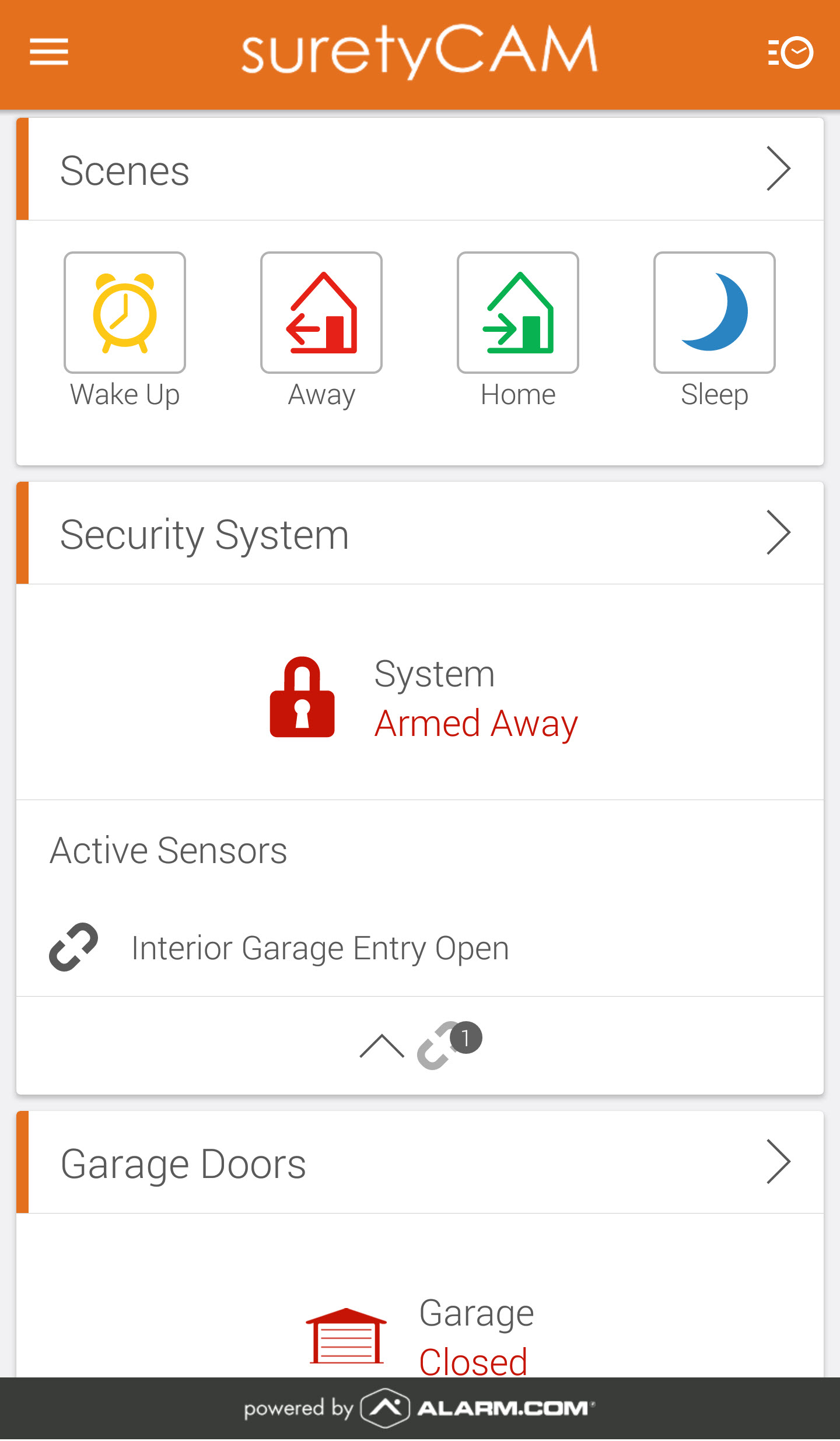

So, weird stuff is going on. The other day, my wife opened amd closed the rear kitchen door. That night, I noticed my app was showing the playroom door was left open. Checked that door (we never open that door) and opened/closed it but it didn’t reset. Then I opened/closed the rear kitchen door and the open sensor was resolved. For some reason, ADC was calling the rear kitchen door sensor the playroom door. I am certain that the programming for those 2 sensors are correct.

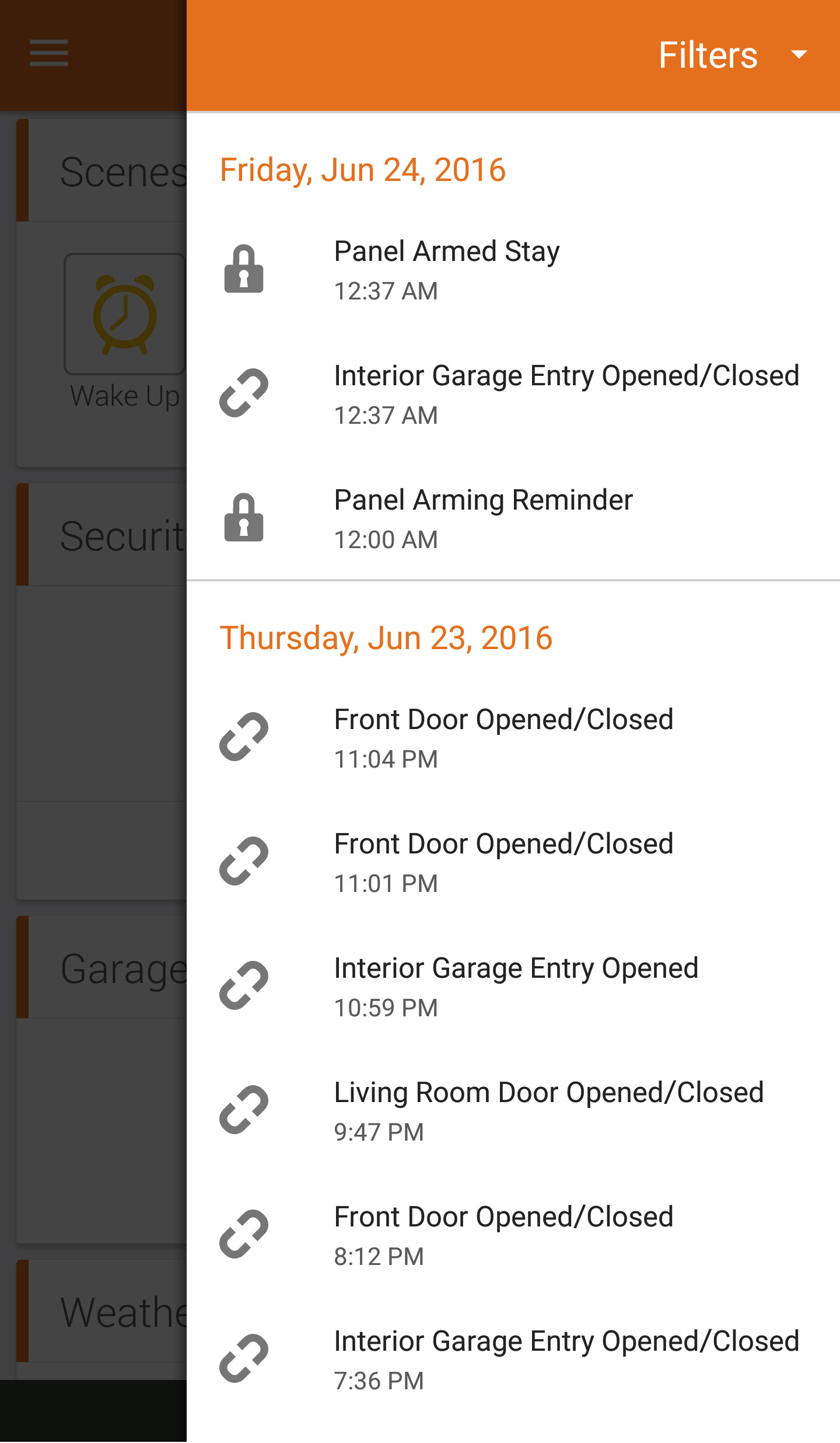

Last night, I went to arm the panel from my phone and noticed it said a sensor was opened at 10:59pm but never closed. I confirmed that it was closed and the panel showed that the sensor was closed (it is an interior entry door, and I had the ARM READY light). I opened and closed that door before arming the panel and a little while later, ADC reported it correctly.
This morning, we exited through that door, and when I was outside, went to arm it from my phone and same thing! It showed that we opened the door but it never reported closed.
This sensor is less than 2 feet from the panel. Not sure what is going on with these misreporting sensors…but it was never this bad with the GC2. It seems to be happening fairly regularly on the GC3 now. Thoughts?

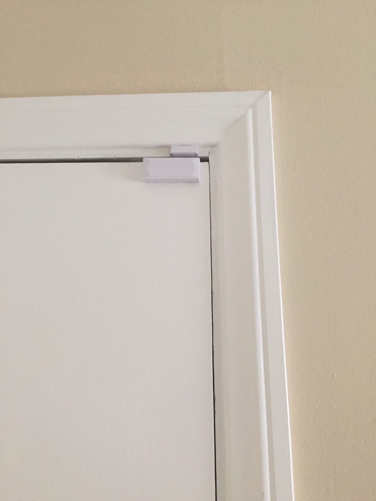

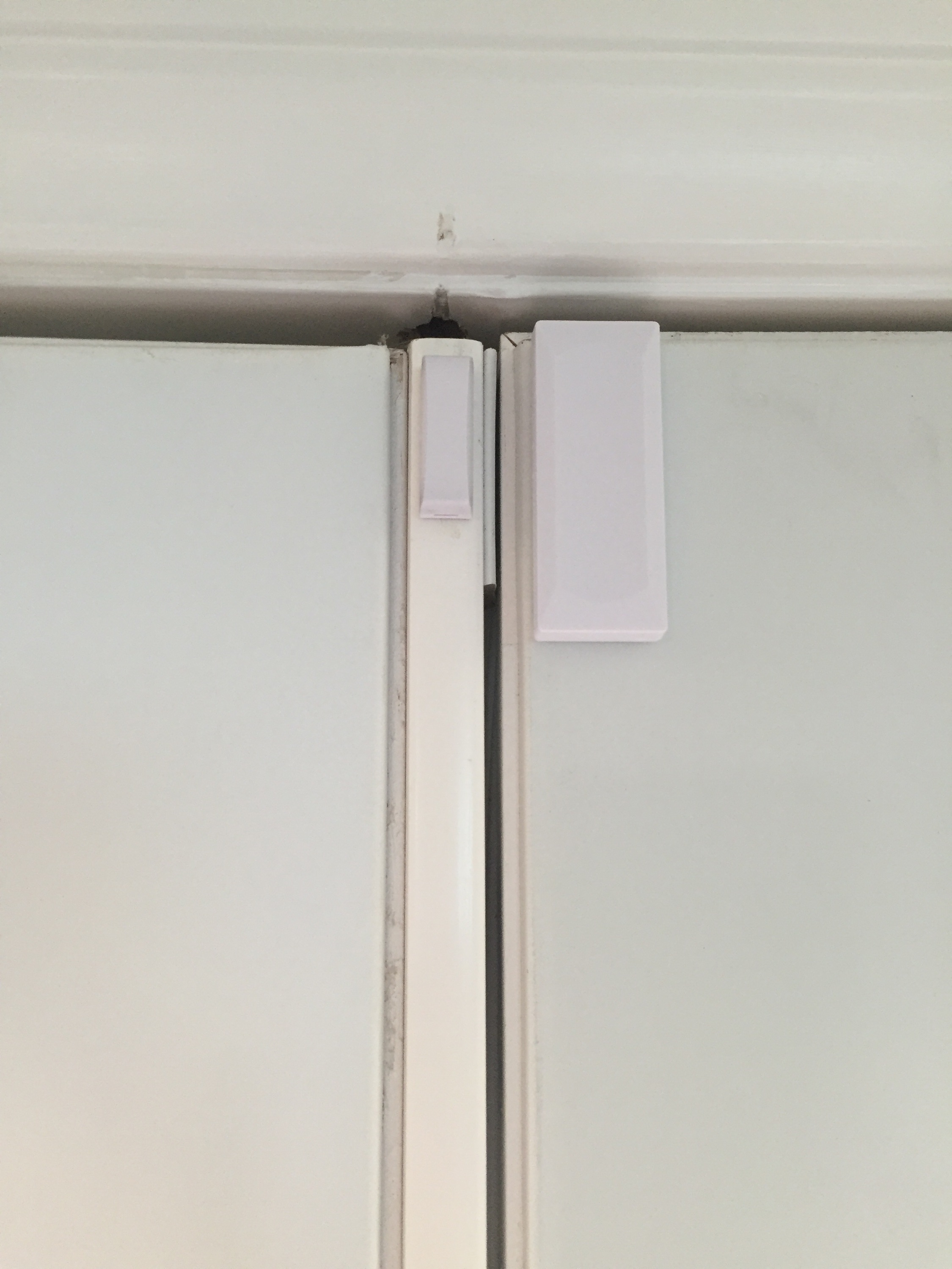

Can you post a photo of the sensors which have done this recently? A photo of how they are mounted in the closed position (door/window fully shut) would help.
I’m talking with Alarm.com as well to see if a pattern can be found.
Attached are the 2 sensors that have mis-reported to ADC recently. Please let me know if you need anything else.

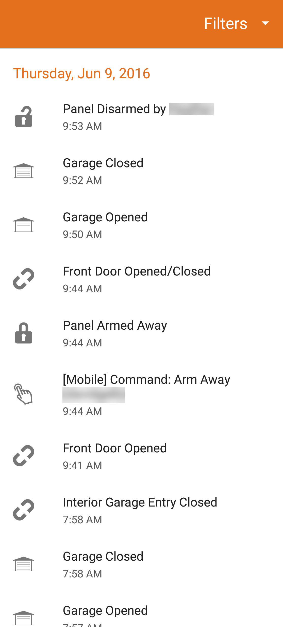

Same issue again last night, this time with a recessed door sensor. It shows that the door was opened at 8:04am yesterday morning and never closed (although it was closed). The panel showed that all zones were closed, so I armed the panel at 12:26am (ADC app still showing Kitchen Door zone was still open). This morning, I checked the ADC app and it no longer showed the zone was open, but it doesn’t show that the zone was ever closed…it just no longer showed an open zone. So, at some point in the night, ADC updated to reflect the correct zone status.
Seems like it is something on the ADC side, since nothing reports incorrectly on the panel.
