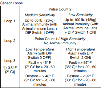

Vista 20p added DT8050v wired motion, now keypad shows fault when setting AWAY

The only thing different should be the loop number depending on what you are needing if you have pets
The motion does have a walk test mode. This activated the LED light for about 10 minutes after installation to test the sensitivity and location.
