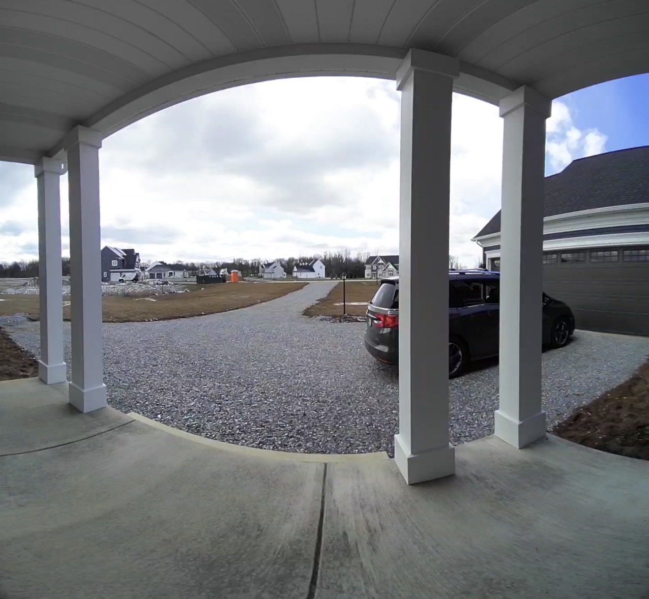

Motion detect is weak so far. Pic below uploaded for reference. The camera will not detect when the minivan leaves the property. Walking by the camera seems to trigger it but only at close distance (you have to walk in the area between the van and the porch). I have sensitivity set to maximum.

Small update on it’s motion detect, it’s consistently detecting motion from the van position and closer. But if the van were not there, it would not see a car coming down the driveway, for example.
