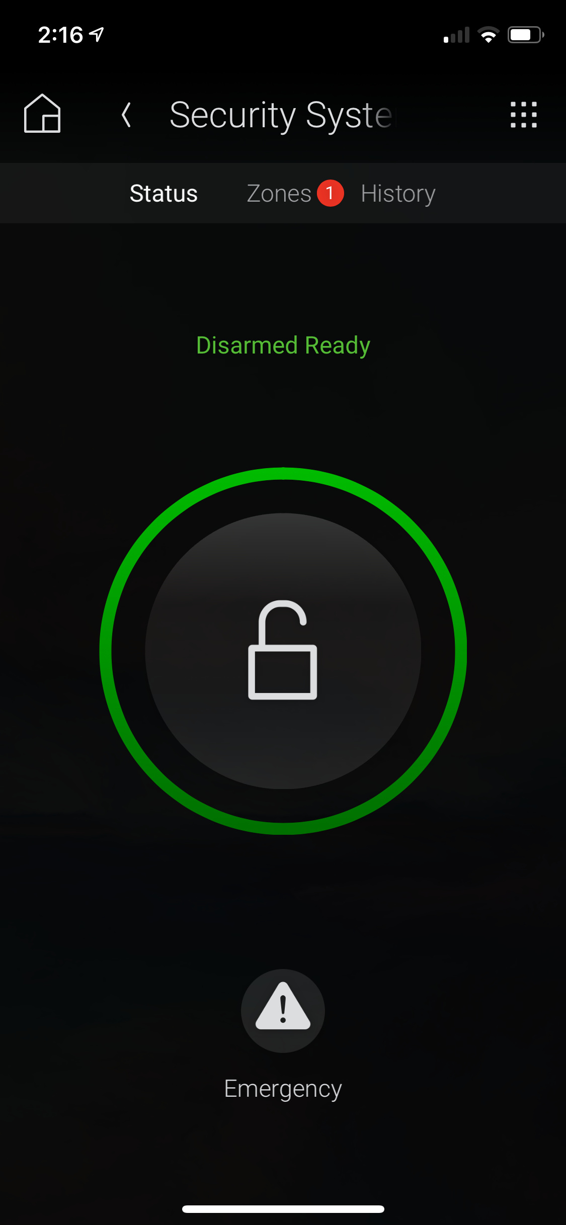

Quick update. My C4 dealer got my IQ panel integrated and it’s working perfectly through my C4 interfaces. I can arm, disarm (by putting in code) and also check status of all sensors. I haven’t tried yet, but I can also include sensor status changes to trigger any of my C4 automations.
Thank you for the update, glad to hear it is working well!
