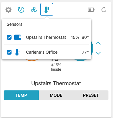

Jason, I just glanced at the website and here are screenshots of what I saw on that card.
The thermostat was showing 78 on its display.
I interpret this to mean that it is still averaging (it shouldn’t be) the temps or the thermostat would read the 80 degrees shown as its temp on the website?

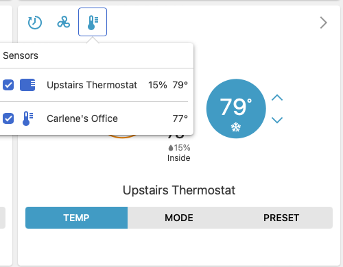

I didn’t get a chance to look at this yesterday, but I just looked at the ADC site and grabbed these from the upstairs thermostat.
It appears to me that the averaging is still happening with the “home” schedule even though the temp sensor was deselected from that the other day. The temp is set to 79, the thermostat indicates 79, the temp sensor indicates 77, but the inside temp says 78. The switch from the custom to the home schedules happened about an hour ago, so plenty of time for things to settle at the new settings.
