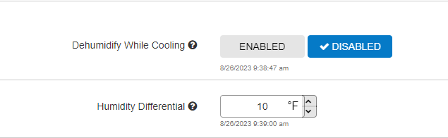

I been using dehumidifier on the same thermostat for about a year. Its more setting issue then a bug. Feature was design to overcool and dehumidify with your AC system and you are using external dehumidifier. There use to be explanation in ADC knowledge base and is no longer there but you have to make sure that your “humidity differential” is set to 10.
That will take care of the issue. rule works correctly if you have that set and you can see that z1 or z2 has a wire connected so thermostat knows that you are using external device.
