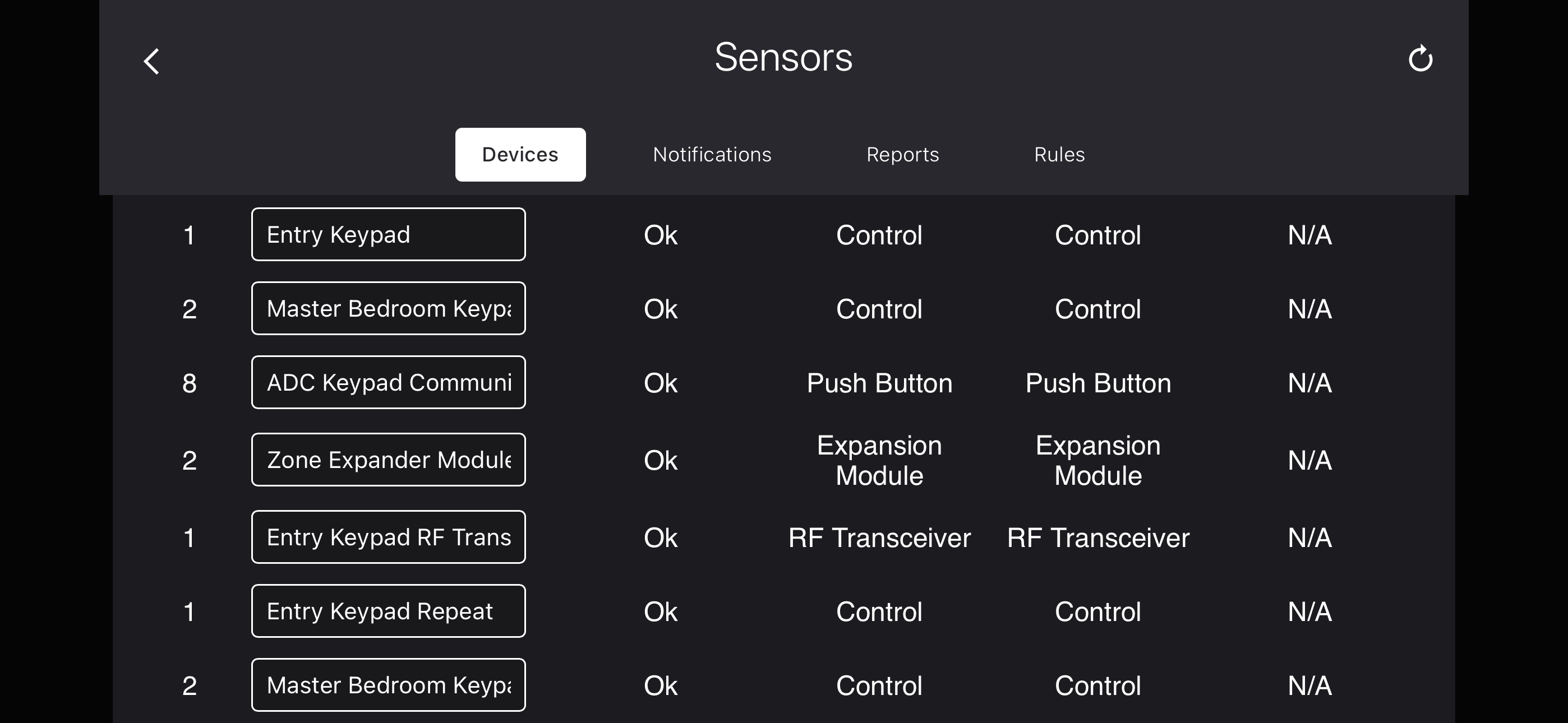

I noticed the system has begun to report additional hardware beyond sensors since the firmware update such as keypads, RF receiver and expansion modules. I seem to have duplicate keypads on slots 1 & 2 in the system sensor list. There is nothing working incorrectly so not a big issue just throws a warning to me that I have duplicate zone names.

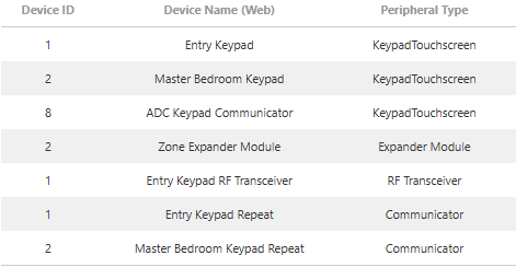

I’m seeing that the keypads are being picked up as the same device number but as a different device type. The RF keypad is picked up as a keypad, rf, receiver, and communicator(this is what I’m trying to figure out). The regular 6160 Is picked up as a keypad and communicator. This could be a separate feature the keypad may have that the alarm.com communicator now picks up.
I currently do not see any duplicate zones.

I’m seeing duplicate keypads replicated on 1 & 2 positions, which I believe are keypads numbers but not the hardware address on the board. These are both labeled as control. Hence why I thought perhaps it was picking up AUI slots. Perhaps it’s just numbering of equipment types and not address as with the zones?
I have a push button control on 8 which I think is keypads 8 address 23 on the board. This should be the ADC communicator?
I see a RF Transceiver on 1 which also made sense because RF receivers are always on address 1 for Vista systems. This would be the 6160 RF so this being duplicate device make sense .
@vidail I also see a zone expansion module on item 2 which I do have one but it’s on device address 8 on the board.
The device manager did not like the replicated keypads 1 & 2 the control devices because when it brought them in it had the same name. I made it a repeat just to clear the error

Below is what I am able to see but it looks like the Reports sections is a bit different on my end. You can see below how it displays on my end.

@vidail any ideas on why device ID 1&2 are doubled as a keypad and communicator? I’m trying to figure out which device is the SEM and which are the keypads. At first I thought device ID 1 & 2 were keypads with some other function that duplicated. Now I see the other 1 & 2 device IDs are the communicator which I assume means it’s the SEM? Wonder if that is the broadband and cellular function? Then in that case Device ID 8 would that be the dealer portal emulated keypad for the SEM?
