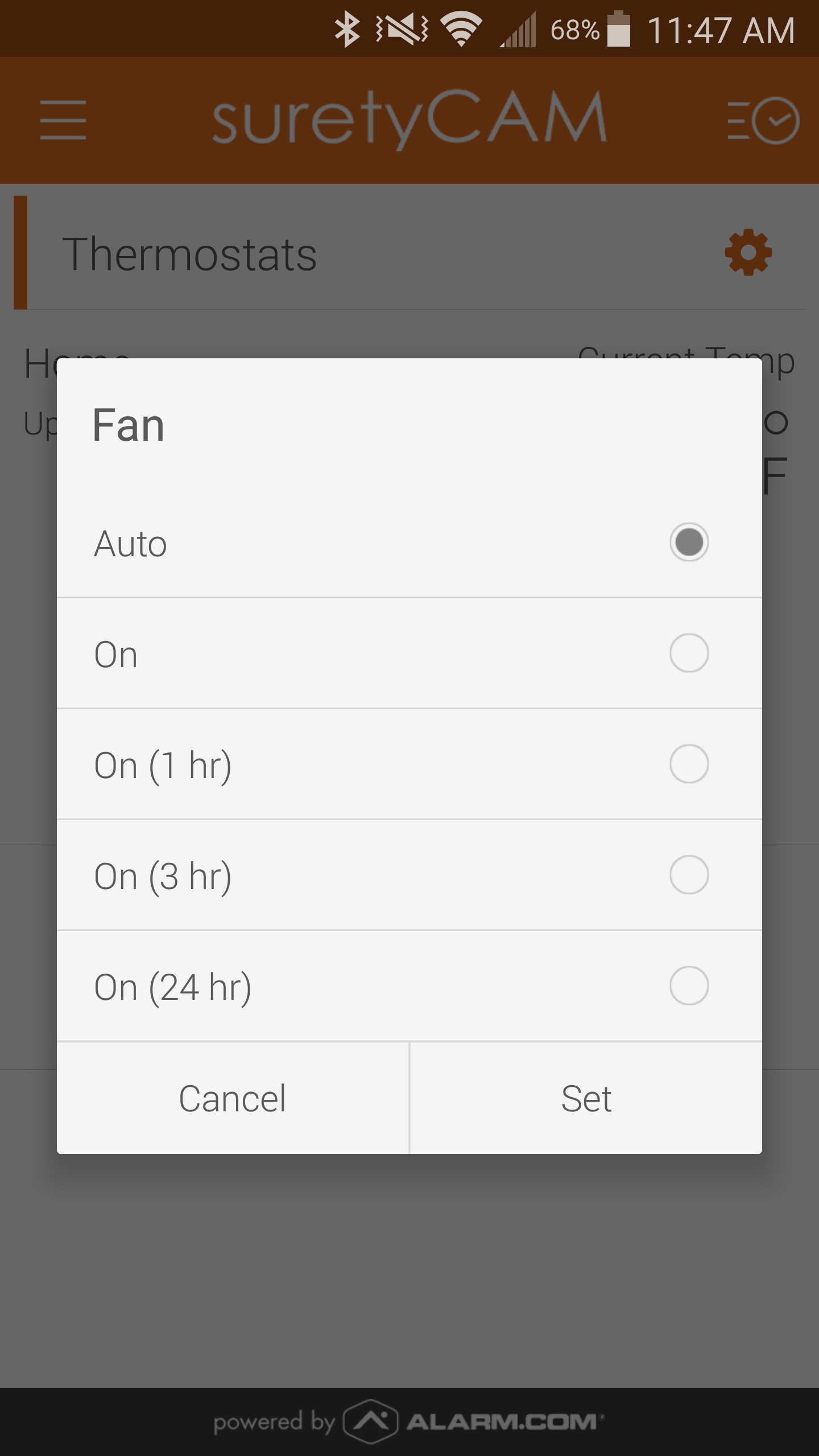

So they have updated the circulate function? because I don’t have fan circulate tab under fan settings.
Circulate should only be available when the mode is off. Check that you have any schedule/mode set to off, then access the thermostat card and check under fan operation.

Ok,it shows up on the Webite when the system is off. Once I set it in the website then I see circulate is selected on the app on my phone.
The website will also let you turn heat/cool back on keeping circulate on. But It only activates circulate when the mode is off like everyone has said.
I use the app 99% of the time and didn’t think to look at the website or think the option would be different.
So far I have seen all of the thermostat options except the fan circulate. The rest of the advance setting etc are on my phone app. Thats why I didn’t even look on the Website.
