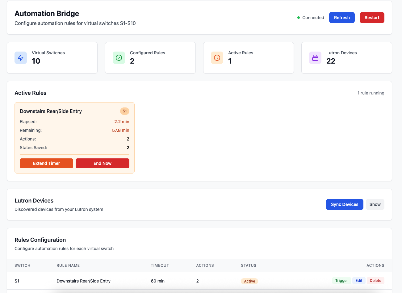

Here’s a look at what I built!
It’s a more robust version of lighting automations that does stuff like saving and restoring light state, only changing lights if they are currently dimmer than the desired state, using multiple motion sensors and doors to continually extend a single timer, using a time-based easing function for brightness (brighter when its light out, dimmer when its dark), and a bit more. It also uses Lutron LEAP to run these automations locally and immediately. From the panels perspective its turning on a z-wave light, and then my software controlled z-wave device does the rest. Would love if ADC could do all this but this works for now!
