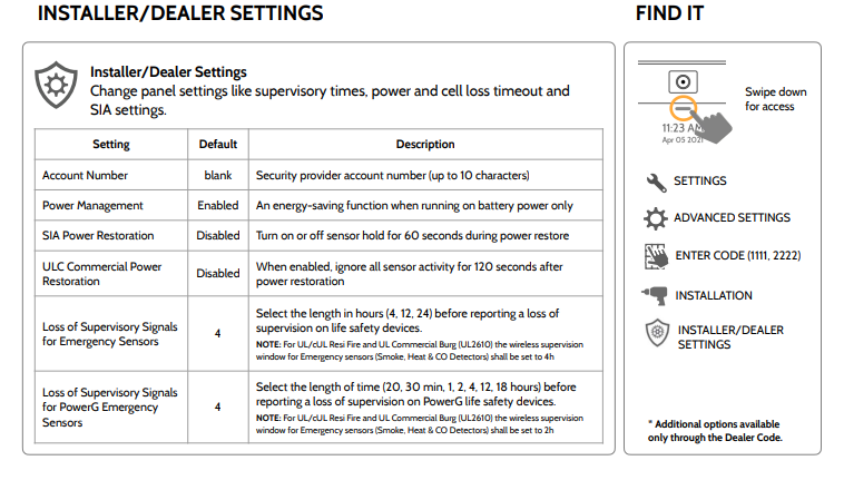

Yes, you should be able to run that on battery by disabling the Power Management setting in the Installer Settings menu.
Thanks, that did the trick. Got a few devices setup tonight.
