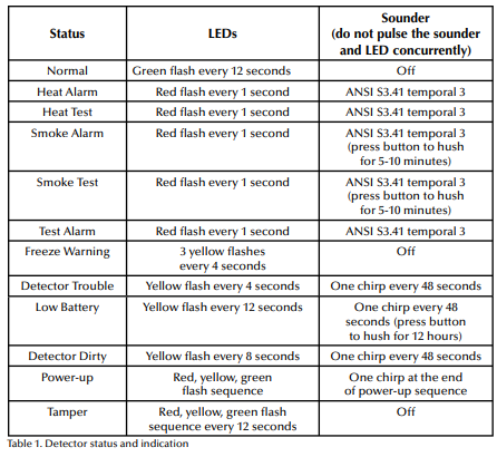

Below is the trouble chart for the IQ Smoke detector. Do any of these match what you are experiencing? Looks like a green blinking light only applied when it is normal and should be about every 12 seconds.
From the history, I can only see several smoked enter tamper trouble. Game area smoke keeps going into tamper. If the head of the smoke is sitting correctly on the base and it is still entering tamper, it may be something with the smoke itself.
