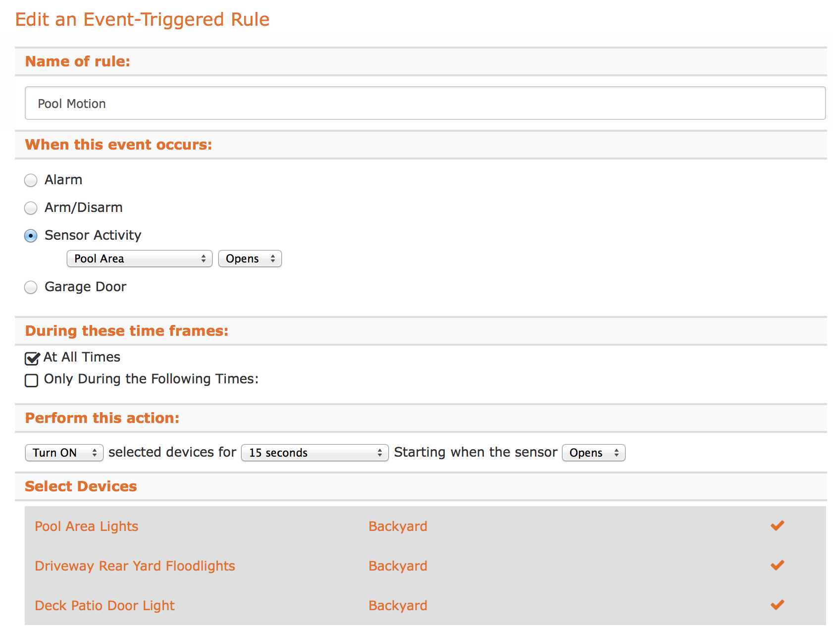

I recreated my rule to use a 15 second and did some testing today. The lights turned on immediately and turned off immediately at 15 seconds. Definitely no Alarm.com transmitting delay.
I’m not sure why I’ve been having issues - perhaps something during the initial setup of my rule the first time?
I attached screenshots of the 15 second rule today that worked like a charm. Jay - thanks for testing this stuff out.

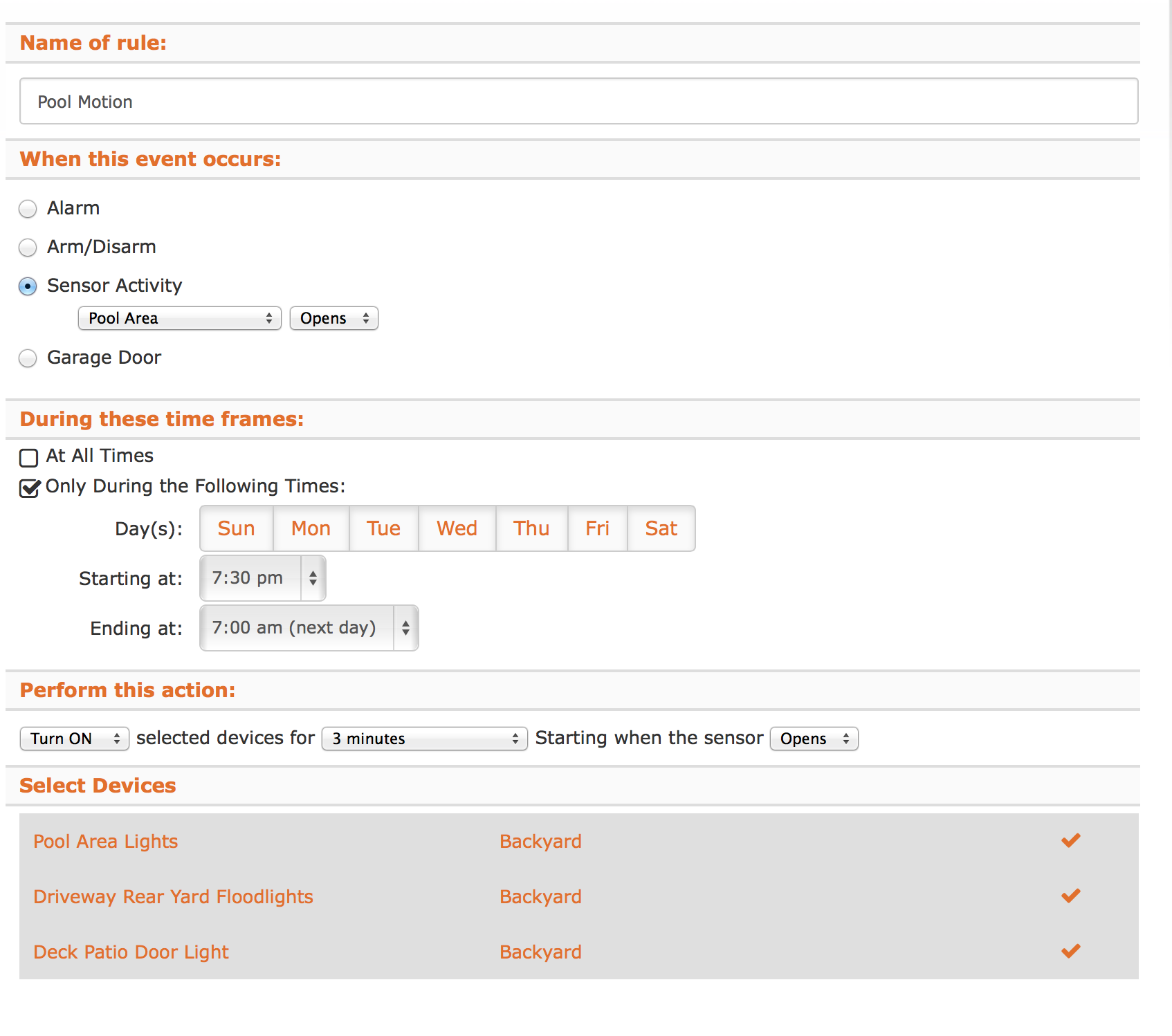

Well - I guess it’s back to troubleshooting time. Rule is set to the attached screenshot - however after walking around my yard tonight for about 45 minutes and then coming back inside, the lights never turned themselves back off
I assume you have these motion detectors’ sensor types programmed as (23) no response type. What do you have their equipment types programmed as? Since they’re motion detectors it would make common sense to program the equipment types as (2) motion. If that’s how you have them programmed then you might try switching them to (1) contact. It’s backwards but it might improve things. 2GIG doesn’t necessarily report the event of a motion detector going inactive to Alarm.com right away, it can take up to 45 minutes. Not that reporting to Alarm.com should have anything to do with this issue, but we don’t know how the codes is written, 2GIG might do better with triggering rules off contacts than motions. It’s a long shot but maybe making 2GIG think the motions are contacts instead of motion detectors would help it behave better.
Yes - programmed as (23). Equipment type is set to (2) Motion.
I did some testing today setting it back to 15 second turn off rule. Here is what I found:
Activate motion detector 1 time:
Lights come on immediately, lights go off approximately 17 seconds later
Activate motion detector, activate motion detector about 5-6 seconds afterwards again
Lights come on immediately after first motion, lights go off approximately 30 seconds after SECOND motion
Activate motion detector, activate motion detector repeatedly for 2 minutes.
Lights come on immediately after first motion, lights go off 3 minutes after LAST motion.
It’s as if there is a bug in the 2GIG code where it is adding the time-off value to a counter for each motion hit. This seems to be consistent with what I’m observing when I have it set to a 5 minute time-off value. I’ve observed it take hours to turn the lights off after I’ve been outside.
I’ll keep working on testing and will change the equipment type to (1) contact later, however this will flood my Alarm.com activity history log with events and I don’t like that as a long-term solution.
