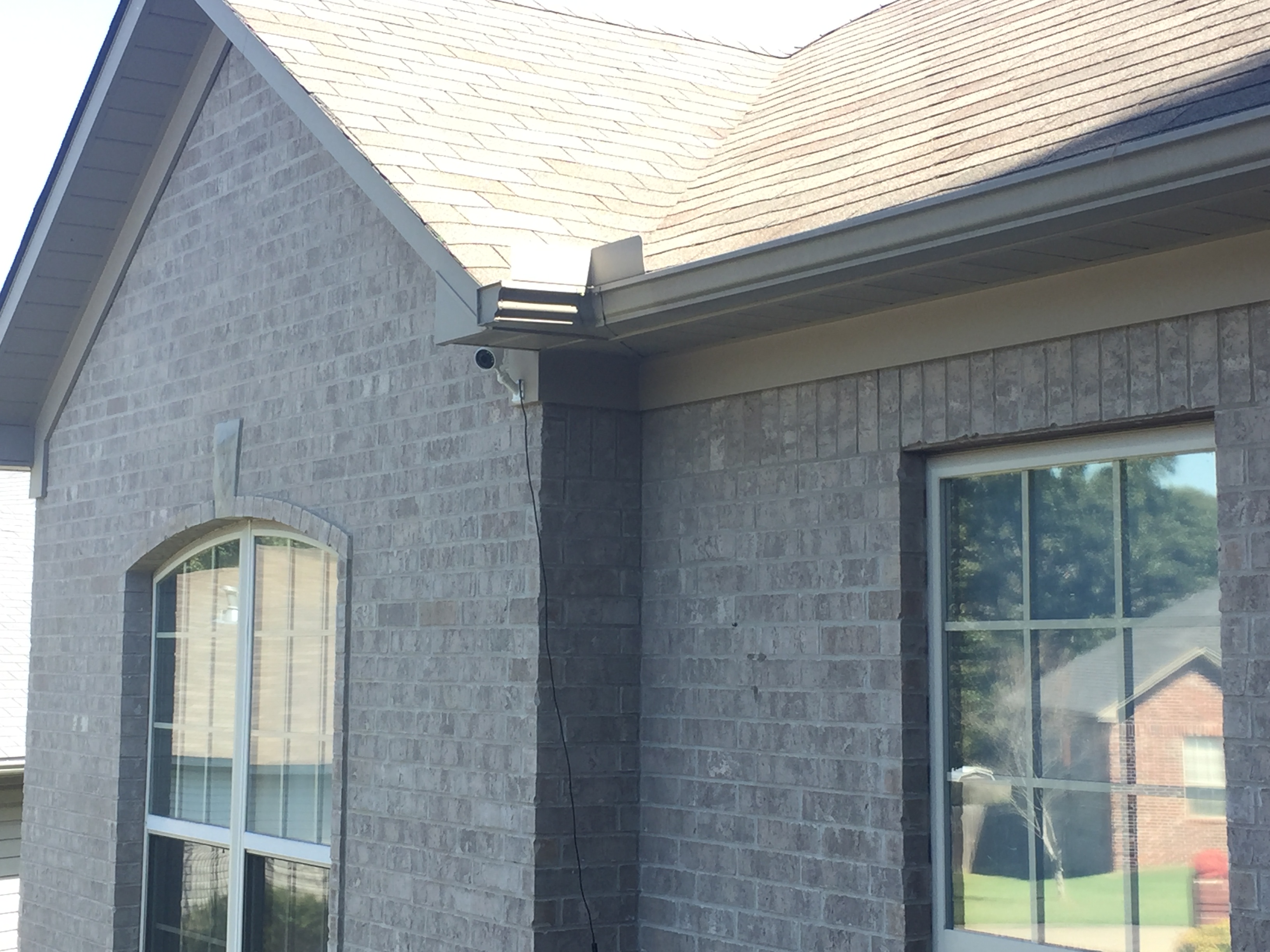

I just mounted a 721w and wanted to see what everyone thinks. Will this spot work? I am pretty sure it will get wet here and all but to the right didn’t work cause it wouldn’t tilt up far enough

Here is what it captures in that location.
The 721W is rated for outdoor use and is IP66 rated. It looks like it should have sufficient cover at that location.
Image looks fine. Remember to use long thin windows for your VMD windows. (think of them as tripwires)

So to cover my whole cam view I’d use 3 and by long you mean from house to road and width being divide whole width into 3?
