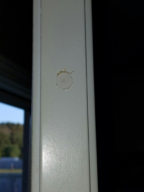

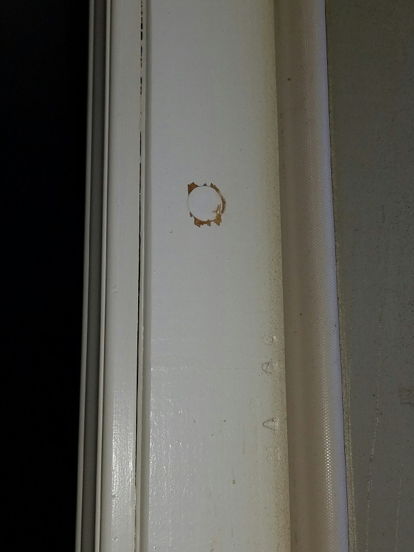

Thank you, there are no wired sensors directly connected to the control panel, which means if there are wired sensors on the doors, they would be fed into a TAKE-345 in all likelihood.
Can you resize the photo of the door sensors from earlier and repost?
I specifically call this out because from the sensor list it looks like you tried to reprogram the two doors as wired zones. Those wired zones in the panel are for HW1 and HW2 terminals, which are not being used.

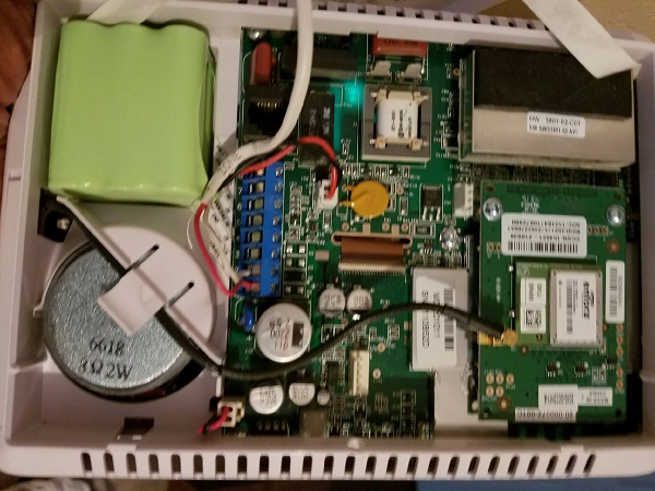

From the image it looks like this panel is using the small 2G cell antenna which fits inside the panel’s side housing. This should not be used for 3G modules. The 3G modules come with an in-wall antenna which should be connected instead.

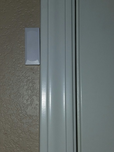

I just submitted the pictures I took of my back door and the inside of the control panel on yesterday. There was not a Take-345 anywhere so I am even more confused. As far as the antenna is concerned, the panel as it is right now is what was there when I moved in 2 years ago. I never touched it until the police started going door to door in my subdivision to let us know of an increase in break-ins. So what should I do about the antenna?
Alright, well you have the odd scenario actually. They are using a DW10 wireless sensor as a transmitter for a wired sensor. That is fine, just uncommon.
These will be programmed as wireless DW10 contacts using Loop 1.
