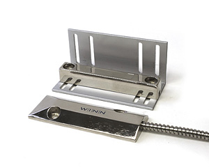

Hi Ryan thanks for the response. Can you clarify what the hub is first. The Gateway (828lm) is located just inside the door where the Liftmaster Control is mounted (888LM), about 10 feet away. The sensor for the door which i dont see on your site, it is an Overhead and Garage Door Contact (picture attached), is about 40 feet from the gateway and 30 feet from the conterller.
OK, so you don’t have a MyQ Garage universal controller (821LM), you have the MyQ Internet Gateway (828LM) and Control Panel (888LM) which works differently. The wireless signals sent between the gateway and the control panel are pretty strong and at that distance they’re probably not the issue. Did you just get a temporary malfunction notification or is it still not working now?
