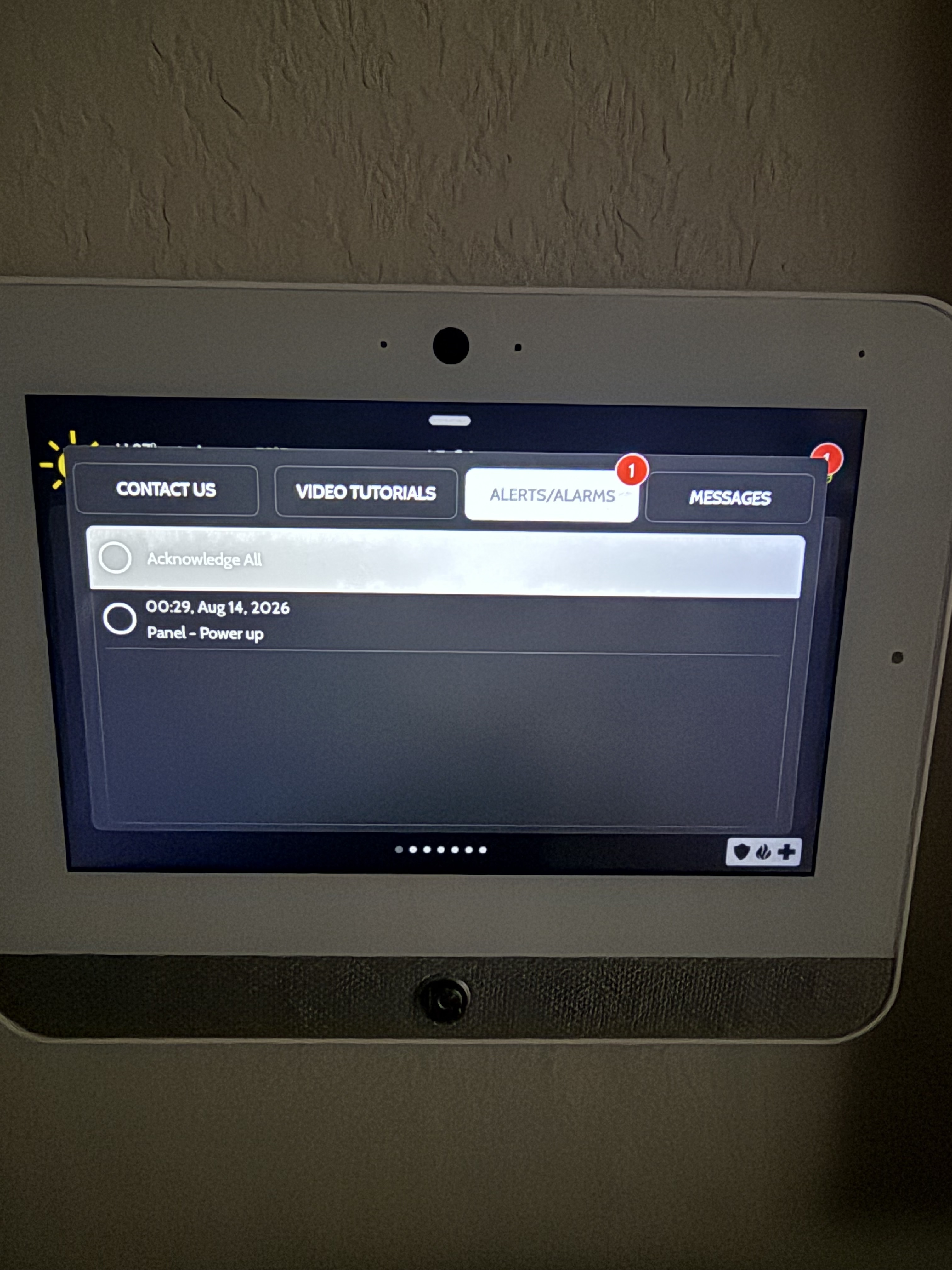

Here is the picture Nicholas asked for every time it happens.
And is the wipe and restore what the engineers recommended?
No, I just heard back from Qolsys this morning.
They’ve released a new firmware version that should fix the random rebooting issue. Can you two try upgrading to the latest firmware? Steps to do so can be found in the guide below. The patch tag for the new update is iqpanel5.1.0
Thank you,
I updated and we will see how it goes.
thanks @nicholas - I just upgraded as well.
Just wanted to report that the update fixed the issue.
Thank you.
