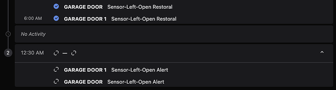

I disabled monitoring for those sensors but still get “Sensor left open” notifications on my garage doors even though they are closed. I do want to know if I left my garage door open but currently it’s giving me false notifications.
Here you can see the notifications that I get about the sensor left open, even though neither were actually open.

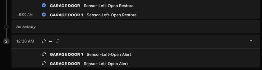

And here’s the configuration for those sensors. The checkboxes at the far right are for monitoring which are unchecked.
Unfortunately if the SEM sends open status events on supervision intervals then this would continue to occur. The panel status would not reflect it is open unless it truly has opened, but in ADC unfortunately this activity would continue and any notifications would be incorrect.
The 5822T looks like it is basically only compatible with regard to alarm monitoring, the panel should report alarm events normally from it (if programmed as an alarm generating zone type) but its status in Alarm.com would continue to show open intermittently for sensor activity or any status notifications.
