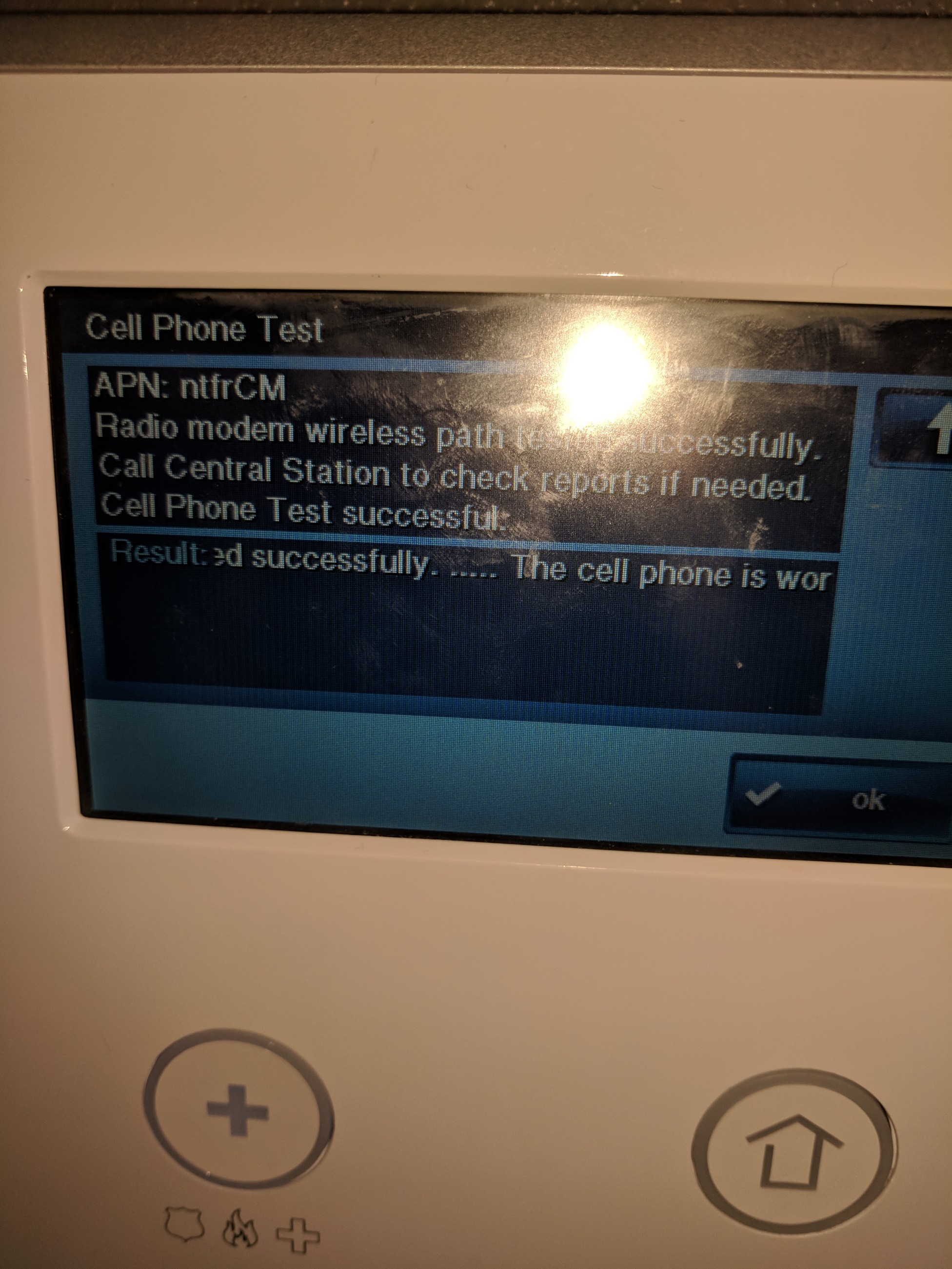

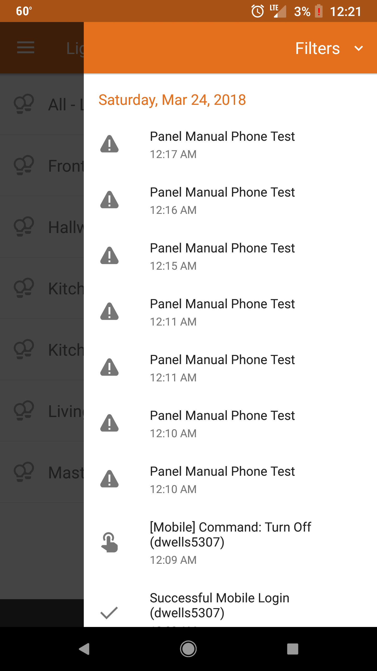

Attached is the cell phone test screen showing an error I am unfamiliar with “APN: ntfrCM”. Also I get an error indicator next the the “Panel Manual Phone Test” event in the ADC app (see attached).

I see a huge number of manual phone tests going through on the account around this time. They were not failing. Even the one in the image you attached is successful. Are you saying you also had ones that failed?
That is not exactly an error indicator, simply the icon that is displayed next to a manual phone test and other system events. All of those are normal phone tests and visible in dealer history.
