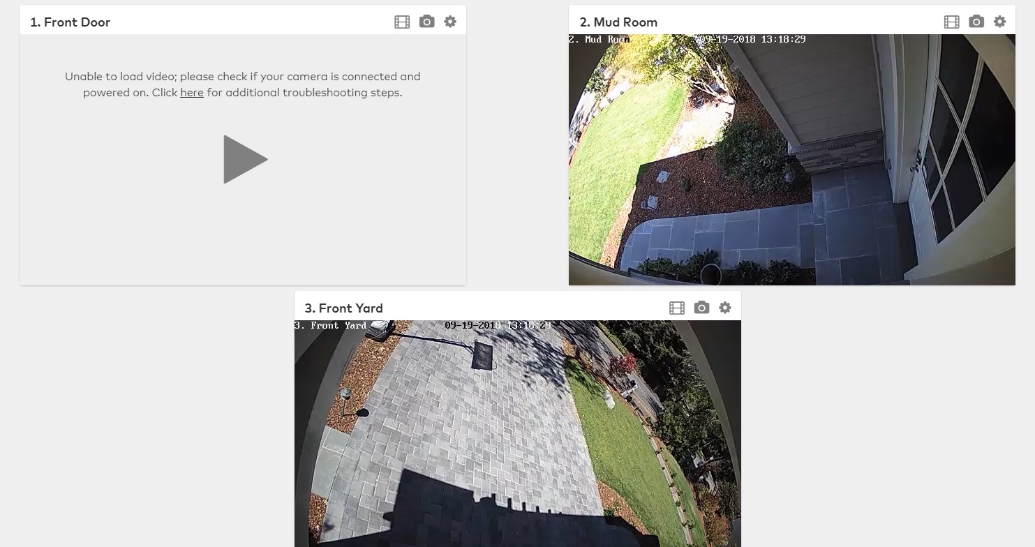

So I unplugged the SVR for 5+ minutes and it appears to be working “better” now on the webpage.
All cameras appear to be staying on for the first page of videos I bring up.
I have 7 cameras. ADC only lets you view 4 max at a time per page. If I open 2 pages up to see all 7, one camera drops out now.
It also seems like if I open ADC, go to Videos, and view one page of cameras it works, but if I switch to the other page with the rest of the cameras, one will drop out. If I refresh that page a couple times and wait long enough I can get all the cameras working. But if I switch back to the other page, a camera will drop out. Almost like they have a limit of simultaneous streams on the page (Let’s say 4?) and when I switch pages to the other cameras feed, it still thinks I am streaming the other cameras (if that makes sense).
Also, before it almost seemed like if I tried the webpage video stream shortly after plugging in the SVR it would drop out quicker than if the SVR was on for a while. Almost like it took time to create a buffer.

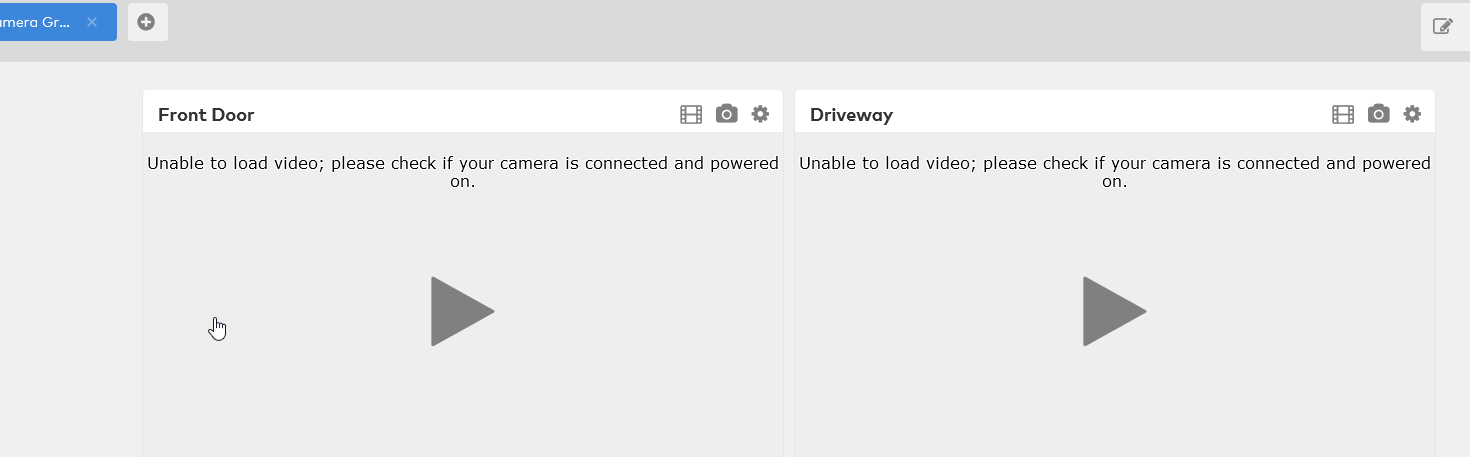

I have the exact same issues described by ImpetuousRacer. I came accross this post on Google via the error he had posted word-for-word. This has been an on-off issues since getting on board since last spring when I joined.
I have 2 HD cameras joined to an ASUS RT-N66U. Camera 1 points to the driveway, the other the front door. The FD camea is physically closerm, and connects easier than the D cam since it’s further away. They both seem to still follow motion detection rules properly, and record when there is movement. However whenever I attempt to view a ‘live’ capture, it fails to connect. I can cycle the cams and it will connect, then disconnect after a short while, but still recording any motion detection.
I can push each camera to record a 50-60s clip no problem and view it in the saved videos list, but can’t get a live feed.
The iOS app also has trouble conencting to the live feed.
@ImpetuousRacer - did you ever close this issue?
Just to clarify, do you mean whenever you attempt to just view the live stream it doesn’t connect?
When you say live capture it makes me suspect you’re referring to manual snapshots, etc., but I don’t think that would be the case.
What is the model number of the cameras? What firmware version are they currently running? This can be found on the Video Device Info page in ADC.
That is correct. Attached a screenshot of the UI. This inability to see these snapshots happened on my PC and in the iOS app.
However it seems I have an update here. I initially was testing from my inside my corporate office network. When I went home and tried to observe alarm.com via my home network, I could view both camera snapshots without issue.
I came into the office today and instead of connecting my laptop to the network, I instead connected it to my iPhone tether cellular network. Under this condition, I was able to see the snapshots load. Attached screenshot #2.
I asked my network guys today if there was anything on our network that could prevent flash content from loading, and they said “Only if it was malicious”. They determine this via a lookup list with a provider. I have to assume that Alarm.com might be on that list?
The behavior is repeated on the iPhone iOS app. Connect to cellular network -> Can view snapshot. Connect to corporate wifi -> Cannot view.
This would explain why the camera recording rules are still triggering and taking snapshots of movement in front of them even though I could not view live shots from the office.
