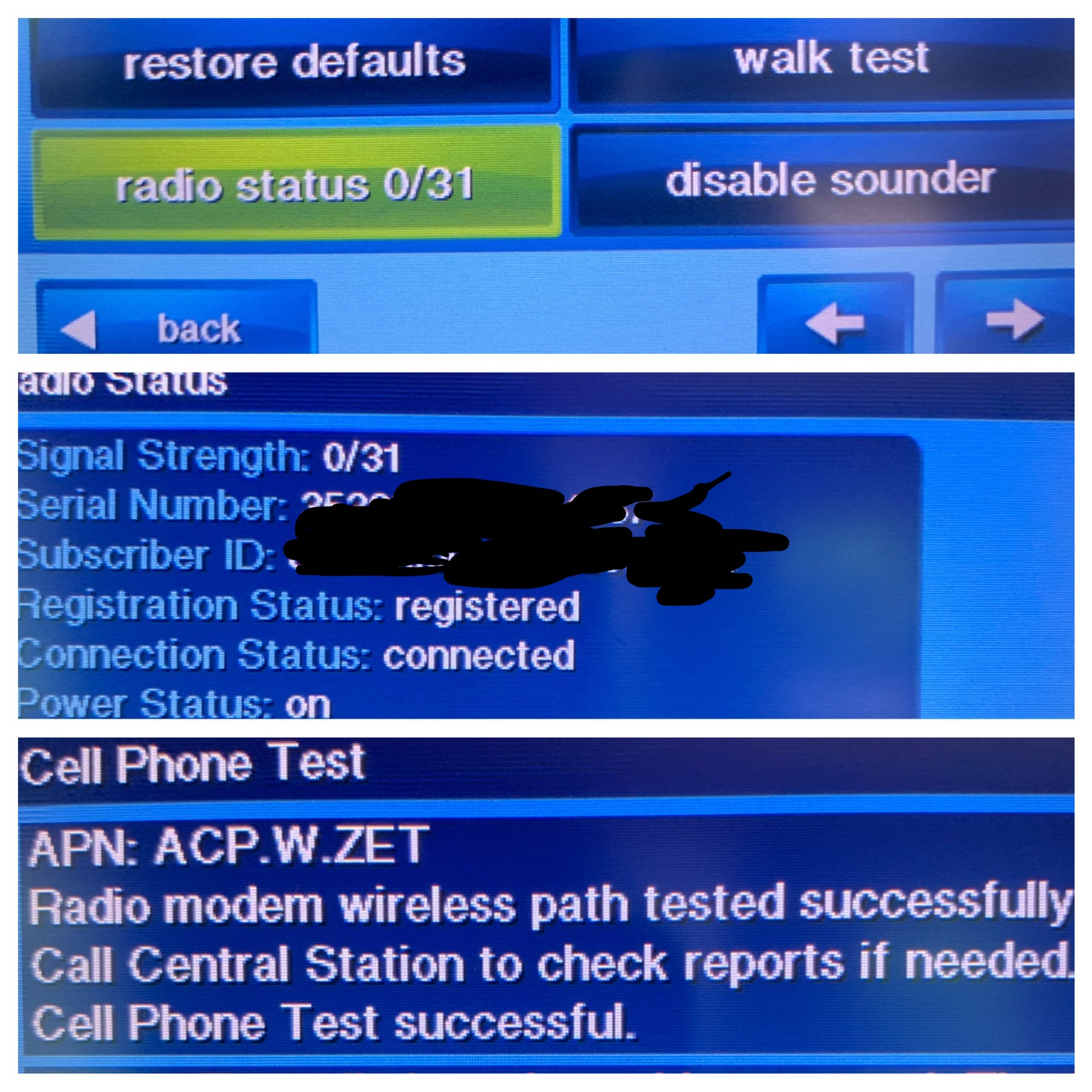

I’ve done some more testing and now realize the problem isn’t any better when the panel is taken outside. The signal strength varies wildly even when no changes in position or location are made to the antenna. The virtual ‘radio status’ button in the installer toolbox varies in color (r/y/g) but does not seem correlated to the signal strength as it used to be.

This is the original module. Actually only one of the pics should have been posted (they’re a collage of 3 shots). I didn’t want to post the one with ID #s. The point was to figure out why with 0 signal the button is green and module worked. I couldn’t delete the other pic, can you?

Strange display (i.e. says 0/31 signal but colored green and can occasionally connect; also occasionally says 29/31 with no ability to connect.
