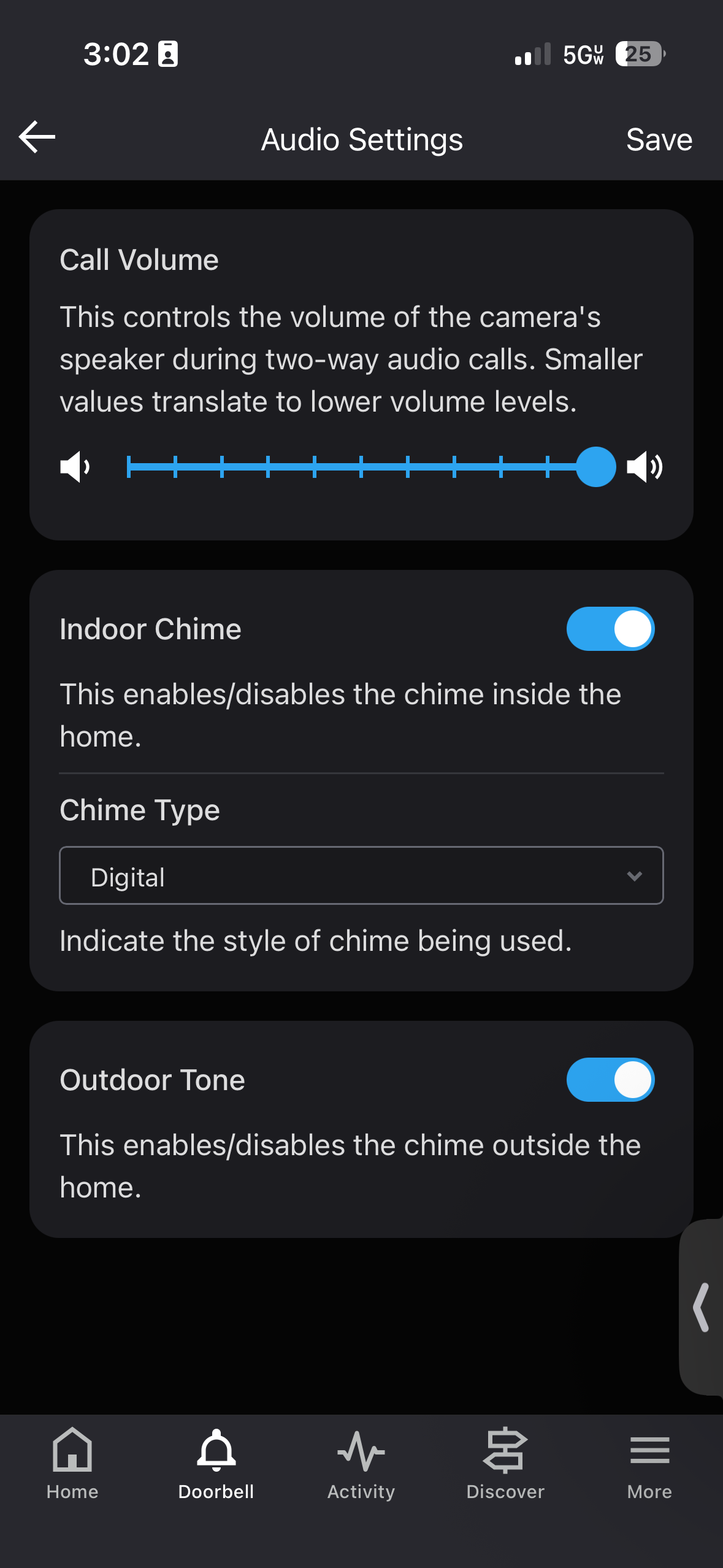

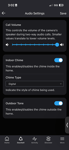

In the Customer app, log in, tap on video, select the gear icon, select the video doorbell, tap Audio, choose the desired option in the Chime Type dropdown, and tap Save.
If this is not set correctly, it can have power issues like rebooting when the doorbell is pressed to even possibly burning out the doorbell.
Thank you, I can confirm it is set to digital.
Can you add a photo of that chime in reply?
I mean the physical chime located in the home, not the chime settings page in Alarm.com. We need to verify the model, power, and type of the chime in the home. The behavior is often consistent with the chime setting not matching the type of chime in the home.
