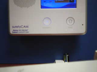

The image sensor won’t have the color vibrancy of a professional Canon, by any means, but it should be in color if the light is not borderline low.
